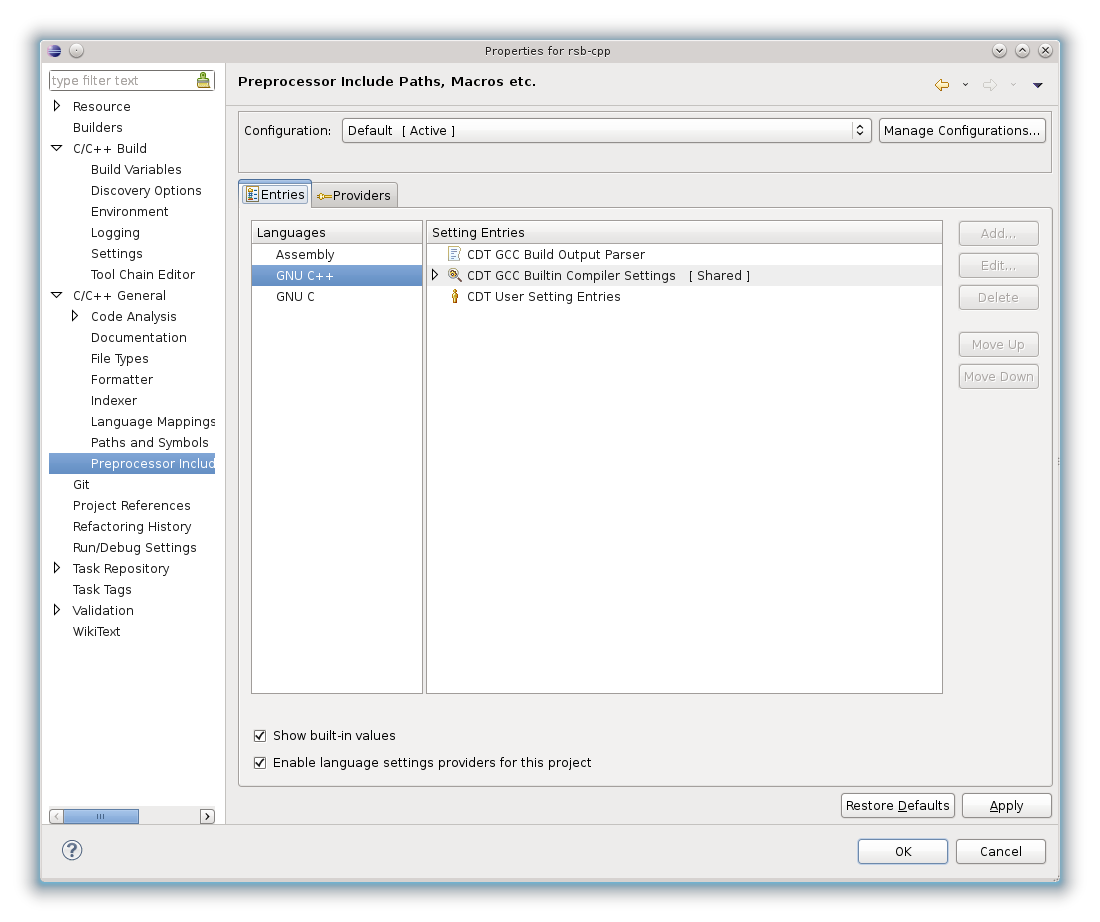

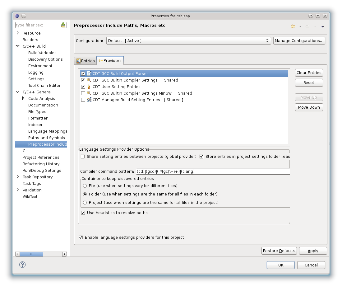

As I have read somewhere, the old Discovery options have been deprecated, so I tried to configure the new settings under "Preprocessor Includes" in my projects to do the job. Attached you find screenshots of the respective settings pages of an affected project. Despite the changes to the "Compiler command pattern", the build output parser still fails to detect e.g. the include path "/homes/jwienke/workspace/git/rsc/src" in the following output of the CMake-generated Makefile:

There is no screenshots attached but you should be able to use pattern (.*c\+\+). See also https://bugs.eclipse.org/bugs/show_bug.cgi?id=395498

Sorry, I forgot the attachments. They are added now. If you look at the second screenshot, my pattern should already cover this case. Still it doesn't work.
