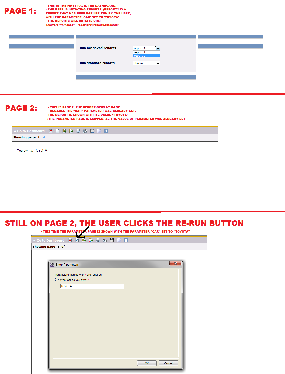

im working on my company's birt-application.
ive just downloaded the repository with package "org.eclipse.birt.report.viewer" and the corresponding packages.
Im trying to figure out where the GET report parameters are set in the source code.
Reason beeing is that i know its possible to set report-parameters through the report url. like this: myreport.rptdesign&myparam=1
I want to put in my custom code that says that if i have set the parametervalue in the session, set this value on the corresponding birt report parameter.
the reason behind changing the source code, is that it seems that its not possible to set report parameters in script. I know its possible to set parametervalue in each "parameter-script", but i want a generic way of setting parameters.
I greatly appreciate all help.
Thanks.

You could save your parameters back to your database or out to a text file or something. Then, when the user wants to run the "saved report", you could pass the parameter values back in, through the session. Then, just hide the parameter screen and set your parameter values in the beforeFactory.
Another option could be to write a "saved report" name back to your database, along with user name, and any other necessary info. Then, when your user info is passed to a report, you could check for "saved reports" and prompt the user if they'd like to load one. The values would be written to text files named by the "saved report" name, so you'd just need to recall the text file, hide the parameter screen, and set the parameters, in the report.
Hope one of these helps.
