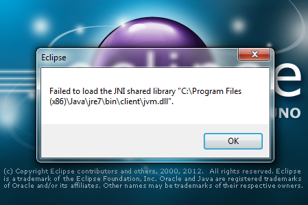

i tried to start eclips but than i get the error
failed to load the jni shared library''C:\program files (x86)\java\jre7\bin\client\jvm.dll''.

  • Attachment: Naamloos.png

You're trying to use a 64-bit Eclipse with a 32-bit JRE. They have to match.
