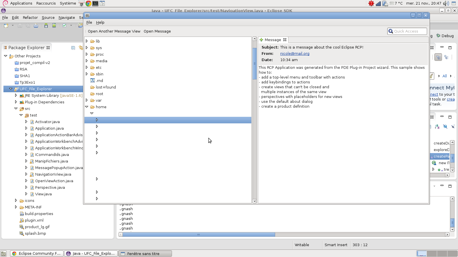

I did what you told me but unfortunately it didn't work. In fact when i click on the "Renommer" button inside my context menu, all i get is an empty treeviewer. I mean that my tree(where all my files and directories are displayed) completely disappears. Below is a piece of my code. This code executes itself when the user clicks on the "Renommer" option inside my context menu. Note that the setValue method is not yet implemented.
else if (actionEnCours.compareTo("ActRen") == 0){
			System.out.println("Rename");
			viewer.getTree().setHeaderVisible(true);
			//new RenameFile(viewer);
			TreeViewerFocusCellManager focusCellManager = new TreeViewerFocusCellManager(viewer,new FocusCellOwnerDrawHighlighter(viewer));
			ColumnViewerEditorActivationStrategy actSupport = new ColumnViewerEditorActivationStrategy(viewer) {
				protected boolean isEditorActivationEvent(ColumnViewerEditorActivationEvent event) {
					return event.eventType == ColumnViewerEditorActivationEvent.PROGRAMMATIC;
			TreeViewerEditor.create(viewer, focusCellManager, actSupport, ColumnViewerEditor.TABBING_HORIZONTAL
					| ColumnViewerEditor.TABBING_MOVE_TO_ROW_NEIGHBOR
					| ColumnViewerEditor.TABBING_VERTICAL | ColumnViewerEditor.KEYBOARD_ACTIVATION);
			final TextCellEditor textCellEditor = new TextCellEditor(viewer.getTree());
			TreeViewerColumn column = new TreeViewerColumn(viewer, SWT.NONE);
			//added the line which you told me
			viewer.editElement(((IStructuredSelection) viewer.getSelection()).getFirstElement(), focusCellManager.getFocusCell().getColumnIndex());
                        //adding the editong support without the setValue method implemented
			column.setEditingSupport(new EditingSupport(viewer) {
				protected void setValue(Object element, Object value) {
					// TODO Auto-generated method stub
				protected Object getValue(Object element) {
					return ((TreeObject)element).getName();
				protected CellEditor getCellEditor(Object element) {
					return textCellEditor;
				protected boolean canEdit(Object element) {
					return true;
What am i doing wrong? Can someone tell me please?

Re: Renaming an item in a TreeView [message #986828 is a reply to message #986788] Wed, 21 November 2012 14:49 Go to previous messageGo to next message
This isn't a problem with my model. I verified several times the model and did a print out of what contains the arraylist. On load the program only loads root files and directories. On expand of a directory containing other files and directories, those names are correctly added to my arraylist.
Now when working with the graphical interface, i can see these root files and folders displayed correctly and i can also edit inline those files and folders names. On expand, i can only see the expand icons for other files and directories. The names have completely disappeared and what i did to verify if ever the files and folders are present, i added the following lines :
column.setLabelProvider(new CellLabelProvider() {
			public void update(ViewerCell cell) {
				System.out.println(cell.getElement().toString());
This piece of code helped me to find out that the correct name of the file or folder showed up on the console but not on the graphical interface.
I'm uploading a screen capture and the source code too. On the screen capture you will notice that i clicked on a folder and the correct name showed up on the console.
Can you please help me with displaying the names please?
Thanks for all Smile
