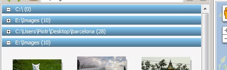

I have a question related with nebula gallery. When I load images from selected directory gallery adds new groups (it's works perfect Smile) but when I want to open directory which was loaded previously is it possible to slide down old group and reload images there instead of adding new group ?
E.g. from my app in file attachment, I want to refresh images in E:\Images instead of create new

You can remove existing groups and items using Gallery#remove or GalleryItem#remove
Then add items/groups at any position of Gallery using GalleryItem(GalleryItem parent, int style, int index).
Or you can also update existing items, see Gallery#getItem(int index) and GalleryItem#getItem(int index)
If current documentation is not enough, you can also search for solution with Table or Tree since the basic API (adding/removing items) is exactly the same as Gallery.

Thanks for reply it works very well Smile
