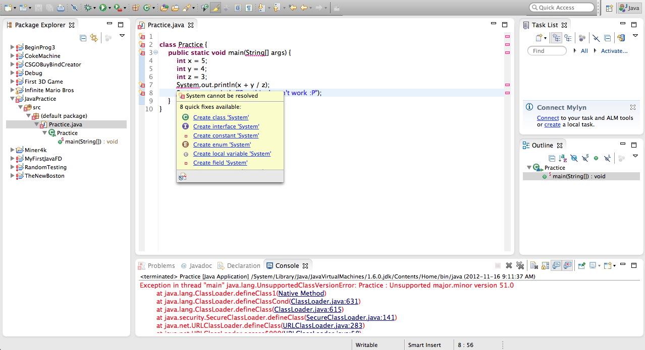

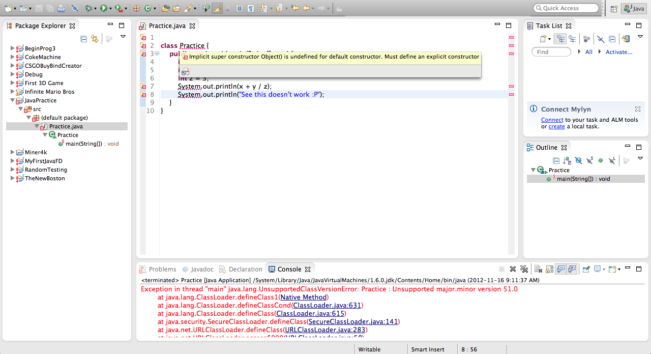

Re: Eclipse not working? [message #985927 is a reply to message #985769] Fri, 16 November 2012 12:21 Go to previous messageGo to next message

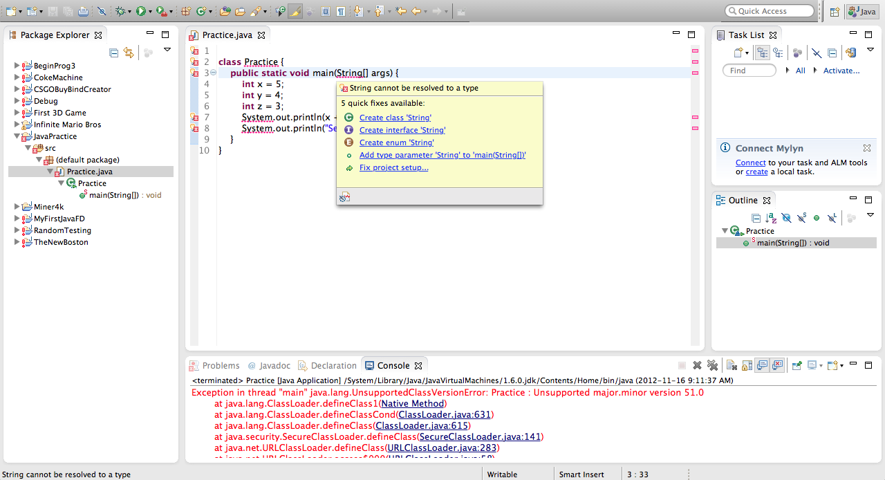

index.php/fa/12370/0/(ok again im not sure if im doing this correctly)
I already did a search about Java not working and Eclipse not working and already got that but im on mac and have no idea about what version i have etc. but i think i found out how to add a screenshot
index.php/fa/12370/0/.
^^Hopefullly you can see this
index.php/fa/12371/0/
^^And these. So these are basically the errors i get on a simple program.
Re: Eclipse not working? [message #985936 is a reply to message #985927] Fri, 16 November 2012 13:02 Go to previous messageGo to next message
The JavaPractice project doesn't appear to have been set up as a Java
project. It's visibly missing JRE System Library. You might be able to
add this by right-clicking on the project, choosing Build Path ->
Configure Build Path, then click the Libraries tab and the Add
Library... button, then JRE System Library and add that. (If it didn't
start out as a Java project, then something else might be broken. It's
easier to start off life correctly.)

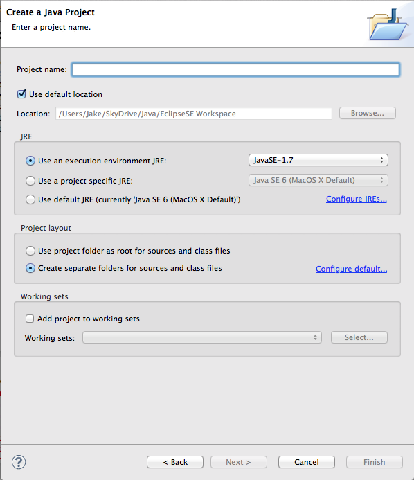

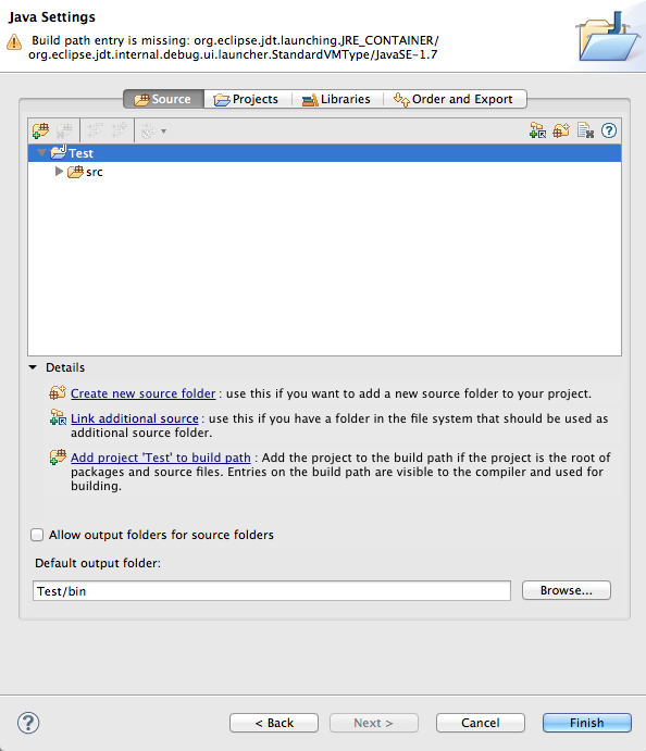

Re: Eclipse not working? [message #985950 is a reply to message #985936] Fri, 16 November 2012 15:39 Go to previous messageGo to next message
Thanks, right clicking and selcting the library works with that project but about creating a new project i click "new Java Project" and it for some reason doesn't put the library in as well..
index.php/fa/12373/0/
index.php/fa/12374/0/
index.php/fa/12375/0/

Re: Eclipse not working? [message #985982 is a reply to message #985950] Fri, 16 November 2012 16:45 Go to previous messageGo to next message
You are selecting a 1.7 execution environment in the New Project Wizard
however, it appears that you don't have a 1.7 JRE defined to your
workspace. You appear to have a 1.6 JRE.
You need to either install a 1.7 JDK and configure it in the workspace,
or switch you projects to a 1.6 execution environment or a 1.6 JRE.
