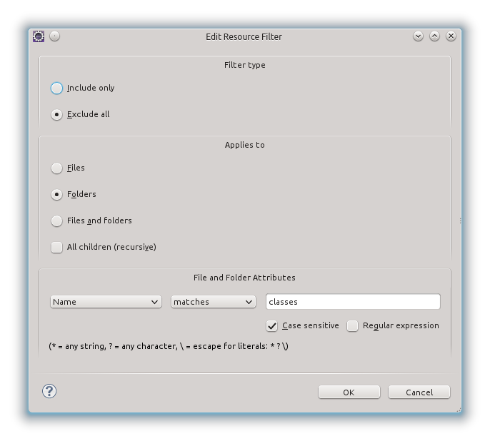

I have now figured it out:
The error is
The feature 'eClassifier' of 'org.eclipse.emf.ecore.impl.EGenericTypeImpl@XXX{platform:/resource/com.pany.eclipse.plugin/target/classes/.../Foo.ecore#//...}' contains an unresolved proxy 'org.eclipse.emf.ecore.impl.EClassImpl@XXX{platform:/resource/com.pany.eclipse.plugin/org.eclipse.xtext.common.types/model/JavaVMTypes.ecore#//JvmTypeReference}'
The important part was "target/classes" (had to spot, it's in the first resource URL).
This means that sometimes, the Xtext builder will see the files created by a command line Maven build (for example when you split the Maven and Eclipse target folders).
To solution is to tell Eclipse to ignore those folders.
Select the folder "target" -> Context Menu -> Properties -> Resource -> Resource Filters (it's a child of "Resource").
Click "Add..." to create a new filter.
Select "Exclude all", "Folders", "Name", "matches", type "classes" into the text field, "Case sensitive".
index.php/fa/16771/0/
If you have a test-classes folder, do the same for it.
