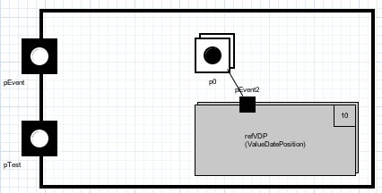

I have a replicated actor reference inside another actor.
I would like to be able to import/deport an actor into a specific slot in the replicated actor ref (array).
At the moment the replicated actor ref creates N instances when the containing actor is created.
Basically I have an array of actors when I'm looking for an array of actor slots I can fill and empty as needed.
