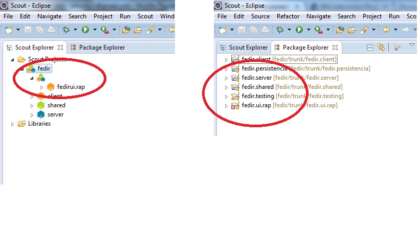

I made a Scout project, shared to a svn server. Then i deleted everything and tried to do a checkout, but the project has errors and the rap bundle is not where it should be, am attaching a printscreen.
How should I share a project?

Hi Sebastian,
You can share your scout plugins with a team provider (e.g. SVN) like any other plugin. There is nothing special that must be done.
The problem in your workspace could be that the previously set target platform is no longer found, because you have deleted that file (that may also be the reason why you have compile errors).
Please try the following to set the target platform again:
1. press ctrl+shift+r and enter "scoutrap.target". You should find one file. Open it.
2. on the top-right corner of the target definition editor press the link "Set as Target Platform". This will trigger a recompilation of your workspace afterwards.
3. When everything has finished, check your scout explorer again. If the RAP ui bundle is still not recognized correctly, restart your eclipse.
does this solve your problem?

Re: SVN checkout [message #982888 is a reply to message #981852] Tue, 13 November 2012 08:59 Go to previous messageGo to next message
this doesn´t solve the problem in the target definition there is no plugins available, i think because when the rap target was created in the original workstation, the directory was outside the worskpace (default dir in eclipse install dir).

Re: SVN checkout [message #986643 is a reply to message #982893] Wed, 21 November 2012 04:46 Go to previous messageGo to next message
Hi Sebastian, Bertin,
Ah ok, sorry, my mistake. By reading your sentence "Then I deleted everything.." I just thought at the workspace but did somehow not get that you also deleted eclipse itself Smile
As this is a very common problem I filed bug 394751. Maybe we find a solution so that the rap target plugins can be shared more easily in the future.
