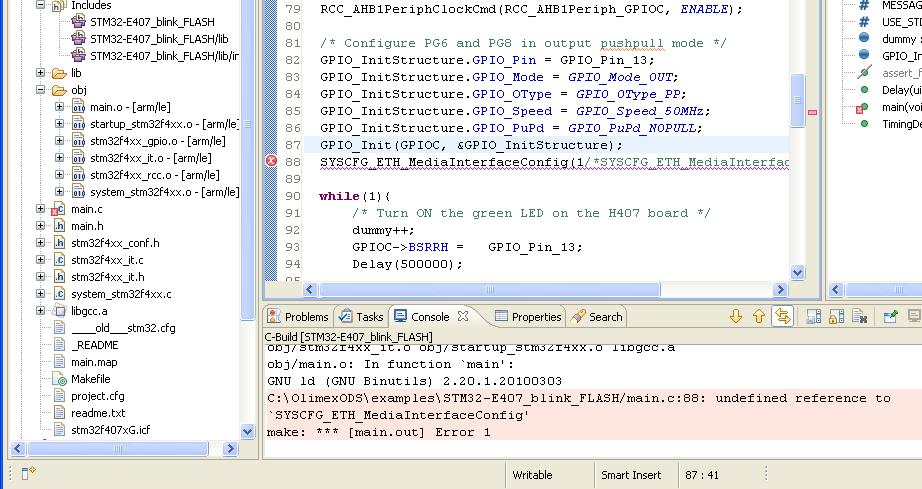

hello ,
moreover the file "stm32f4xx_syscfg.o"
is not in the obj folder when I give build project command
It seems the compiler doesnot compile stm32f4xx_syscfg.c
and add it to obj folder
so it cannot find the respective function in the obj
I looked at makefile file
there also the above file is not listed
I added a screenshot image from eclipse
I must add that the eclipse errors help menu is very limited too
othervise I didnot ask it here in the forum
