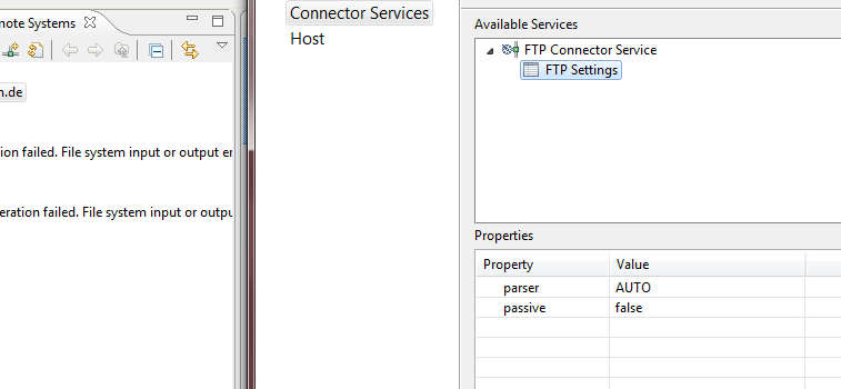

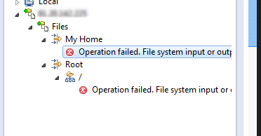

I try the FTP Only connector to connec t to my FTP Host. The connection looks good but when i click on
Files -> MY Home
or
Files -> Root
i get everytime
"Operation failed. File system input or output error"
instead the folder structurr on the external server ftp folder
How can i fix this?
Is their any other ftp plugin i can test under ecplipse?
index.php/fa/12224/0/

Try Window > Show View > Other... : Console
Switch to the FTP Console, it displays the FTP server interaction.
One possible problem is that your server requires passive mode. This can be configured in the connection wizard, a request is open for making it the default:

i try this and passivemode. no difference
