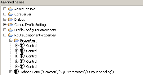

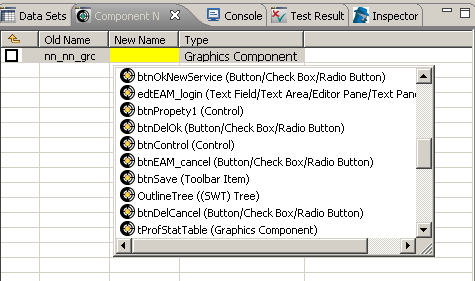

Hello.
Could you please show the way to preserve hierarchy in Component name browser.
I mean - here is a sample of how components/objects look in ObjectMappe - OM.png
index.php/fa/12213/0/
Here components are well organized, but in Component browser I see a flat list of components - CB.png
index.php/fa/12214/0/
So, when there are lots of UI elements in the projects it becomes hard to find proper component. Moreover in case of pretty similar elements like some common buttons, edits etc. but placed in different dialogs/tabs and so on I have to give them various names instead of common naming (like: btnTab1Ok, btnTab2Ok, btnDialogOk instead of having one btnOk per each button under corresponding hierarchy level).

For the component names issue, my suggestion would be to use naming conventions for the component names that reflect:
- Where the component is
- What its function is
- What type of component it is
e.g. LoginDialog_Username_txf
This way, you can quickly reduce the amount of suggestions by starting to type the beginning of the name. More information is available in the user manual in the best practices section:
http://help.eclipse.org/juno/topic/org.eclipse.jubula.client.ua.help/html/manual/node349.html
So, while there is no support for what you mention, the same effect can easily be created with some naming conventions.
