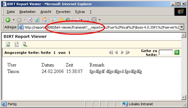

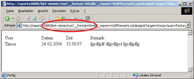

Re: URGENT: A charting challenge [message #140930 is a reply to message #140907] Tue, 07 March 2006 11:51 Go to previous messageGo to next message
Hello David,
to make it more clear:
I want to run the subreport (report #2) WITHOUT the options in the header of
the result-webpage visible.
There are options visible like show content, execute report, export data,
move to previous page, next page, etc.
So the difference is running a report by:
http://reports:8080/birt-viewer/frameset...
or
http://reports:8080/birt-viewer/run...
You can see also attachments:
What I get now running the subreport #2 is see: birt1.jpg
What I want to get is see: birt2.jpg
Hope it makes it more clear, thanks!

Re: URGENT: A charting challenge [message #141010 is a reply to message #140930] Tue, 07 March 2006 13:15 Go to previous messageGo to next message
Ok, I understand, I don't think there is a way, it will always use the same
url as the original report. I might be wrong, but if it were possible, there
should be an option in the url builder dialog. You can probably file an
enhancement for this in bugzilla.

I investigated a workarround until the problem gets solved by BIRT
developers.
To avoid a subreport running unsing the framset?__ ... method, there is a
different way to start a subreport:
Assume we already have a mainreport (e.g. bar-chart type) where you want to
add interactivity if one clicks a certain bar of this chart:

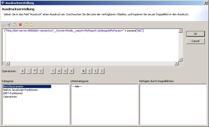

6. Click the ... button to open the expression builder (see attachment
step6.jpg)
7. In the expression builder enter the full URL to your subreport using the
RUN option, e.g.:
http://birt-server:8080/birt-viewer/RUN?__format=html&__ report=MyReport.rptdesign
// here you can use the RUN option instead of the (default) frameset option
you can also transfer a parameter of the main report into the URL of the
subreport, so additional values from the main report can be transferred to
the subreport, e.g.:
" http://birt-server:8080/birt-viewer/run?__format=html&__ report=MyReport.rptdesign&MyParam="
+ params['ABC'] // ABC is a report param of the main report, using this way
you can put a report parameter from main report to the subreport
8. Click OK in the expression builder and click OK in the Hyperlink options
window
