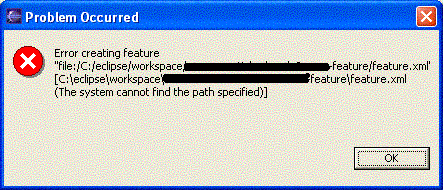

My feature project is located outside the default workspace.
When using the Preview action for a feature manifest the location of the
feature.xml seems to be assumed to be in the default workspace.
e.g. The message attached is produced stating that the location of the
feature is under the default workspace. However, when I created the feature
project I chose a different project location.
Preview is not a big deal....However, my update site project cannot build
the feature. I suspect it fails for the same reason that the preview does
b/c if I create an identical feature under the default workspace, the
preview action and the update site build work fine...:-(
Are there any tricks to create a feature project (and an update site)
outside of the default workspace?
Cheers, John
