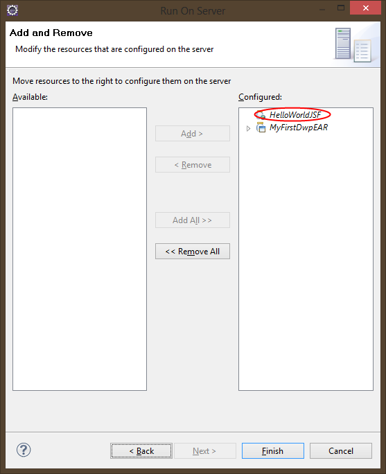

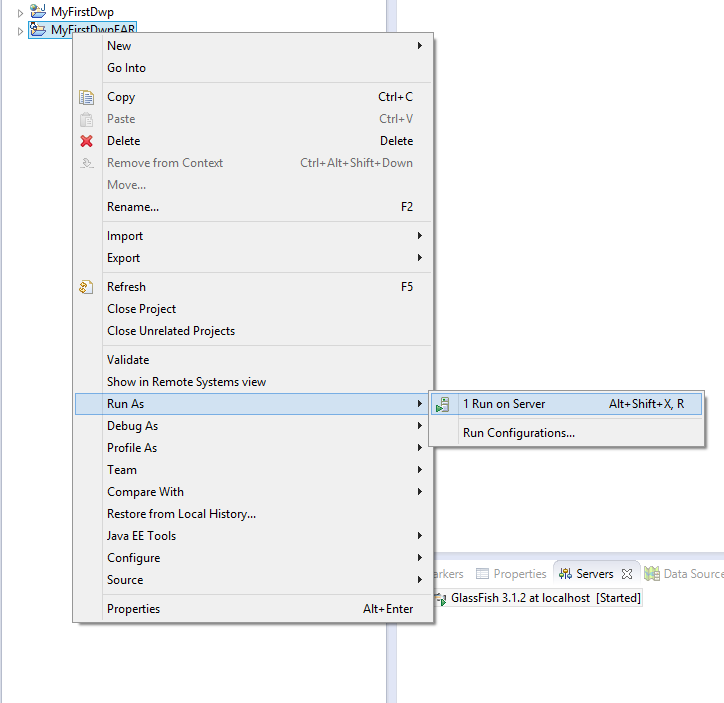

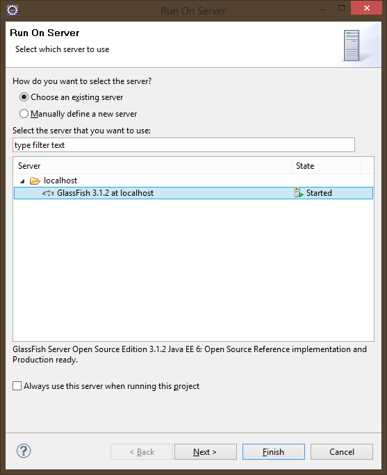

I created a Dynamic Web Project called HelloWorldJSF and ran this project on the server (Glassfish 3). Next, I deleted this project from Eclipse and created a new project, MyFirstDWP.
When I try to run MyFirstDWP on the server the Add and Remove dialog still shows HelloWorldJSF as an available resource even though I deleted it.
Initially I thought Eclipse might be getting the resource list from the Glassfish server so I completely uninstalled Glassfish and re-installed it. Again, when trying to run my project HelloWorldJSF was still there. I suppose this means that Eclipse is storing the resource information locally. If so, where is this information saved and how can I delete HelloWorldJSF? (Note that I don't mean remove it from the resource list each time I want it to be totally gone.)
I have attached some screenshots to help illustrate my question.

This is the JDT forum as opposed to the WTP forum (http://www.eclipse.org/forums/index.php/f/88/) which would be the proper forum in this case. Hopefully I will be able to help you, though.
You shouldn't have to delete the files manually. If you remove the HelloWorldJSF project from being deployed on the server and then perform the clean action, it should delete the files. If for some reason, due to not handling the case of the project having been deleted, this doesn't work, then the files (at least for me, using a Tomcat instance) are stored in $(WORKSPACE_ROOT)/.metadata/org.eclipse.wst.server.core/tmp0/wtpwebapps
