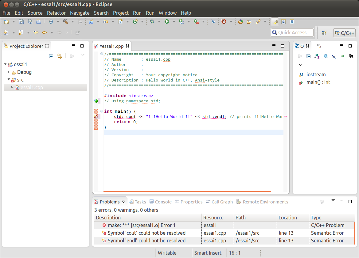

This is a screenshot of what I get.
Thanks for helping Smile

That is an error message from the Eclipse static code analyzer CODAN (semantic error) not from the compiler. CODAN depends on a correct index about header files and symbols. The index seems to be incorrect in your case. Select your project and open the context menu. Select Index->Rebuild. This should fix your problem (usually the index is updated automatically).

I played around with options in the same menu, then found that inclusion of <iostream> was unresolved.
How can I fix this ?

The include path for system headers like iostream should be found automatically by Eclipse. Did you select the correct tool chain (gcc) in Project Properties?
