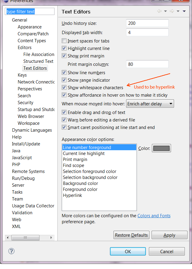

I just upgraded to Eclipse Indigo SR2 and am dismayed to find that whitespace character opacity can no longer be adjusted by clicking on the words "Whitespace characters" within the Preferences -> General -> Editors -> Text Editors pane.
Was this feature removed? Or was it always part of Zend's Eclipse + PDT distribution? (I was using Zend's distribution, but replaced it with eclipse.org's, because Zend's is out-of-date.)

Can you attach a screenshot of it?
Re: Adjust whitespace character opacity [message #956401 is a reply to message #955527] Wed, 24 October 2012 09:30 Go to previous messageGo to next message
Sure, here you are!

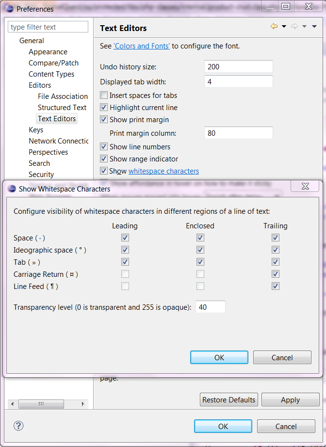

Re: Adjust whitespace character opacity [message #956402 is a reply to message #956401] Wed, 24 October 2012 09:33 Go to previous messageGo to next message
Also, here's a screenshot of the outdated Zend PDT distribution that shows the functionality that now seems to be lacking.
Thanks for your willingness to look into this, Nitin!
Re: Adjust whitespace character opacity [message #956654 is a reply to message #956402] Wed, 24 October 2012 13:54 Go to previous messageGo to next message
Is there a "configure visibility" link that's clickable instead in Indigo?
Re: Adjust whitespace character opacity [message #956715 is a reply to message #956654] Wed, 24 October 2012 14:57 Go to previous messageGo to next message
Oops! It looks like I have this backwards. I'll attempt to clarify.
I was using the latest version of Zend Eclipse PDT but found one particular bug intolerable ( https://bugs.eclipse.org/bugs/show_bug.cgi?id=365526 ). I assumed that the latest build of Zend Eclipse PDT would use the latest build of Eclipse, but that turned out to be a poor assumption. The "About" dialog in Zend Eclipse PDT is completely useless (it doesn't specify the version of Eclipse on which it is based), but the splash screen does say Helios.
Now, it was the Zend Eclipse PDT, built on Helios, that offered this handy whitespace character opacity setting.
When I replaced Zend Eclipse PDT with Eclipse Helios SR2, that's when the functionality disappeared.
After reading your most recent reply, it occurred to me that I must have been using Helios and not Indigo. Sure enough... my mistake!
To make a long story short, I installed the very latest build (Eclipse Juno SR1), straight from eclipse.org, and now I do see the hyperlink and it looks exactly as you describe: Show whitespace characters (configure visibility) <- the parenthesized bit is a hyperlink.
