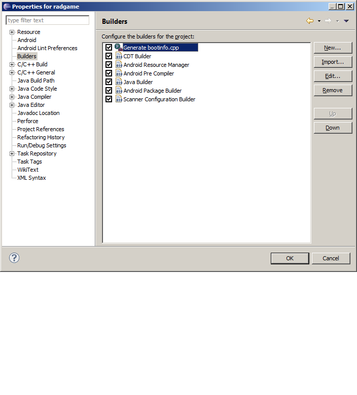

The Builder works fine locally, but after I submit that change to Perforce, anyone who syncs up gets an error. If they open the Builder settings for the project, the Builder I added has been replaced with an error message:
Quote:Invalid external Tool

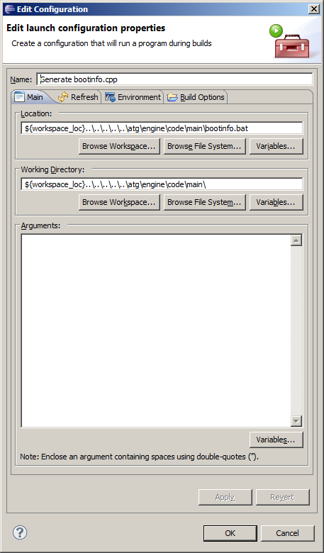

Testing things further, I had the user manually create a new Builder with the exact same name locally. They then closed Eclipse, and revert all the changes they made. So at this point, there local project matches exactly what they had before. But now when they open up Eclipse the Builder I commit loads fine!
This implies that there is some local setting that tells Eclipse "don't delete the .launch; it is needed" and by simply creating one locally (even reverting that change after) that message is set.
