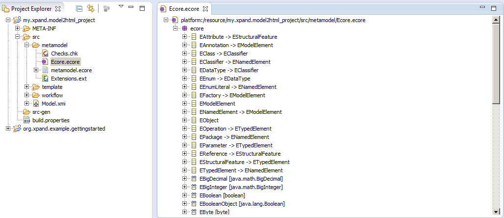

I have a question about Xpand language . Is it possible that Xpand access the elements of a ecore metamaodel for example ecore.ecore , which does not have model.XMI ? ,attache ecore metamodel ecore.ecore

Hi ,
For example in my template I want to write something like
for all elements in Ecore
Node_def(element,'attri','attri')
How I can traverse all elements with their attributes .
For the Example of xpand proposed in Eclipse when I create xpand project and choose Generate a sample EMF based on xpand project , I have the metamodel.ecore and when I want to create model.xmi , I choose Eclass "Model" and create dynamic instance from it and continue build my model.xmi accoeding to the structure of metamodel .
but in metamodel ecore.ecore I can not create Model.xmi from it .as I do not know
Which Eclass in ecore.ecore should I choose to create dynamic instance . How I can access ecore.ecore programatically via Xpand
sorry for my bad english and bad explanation Embarrassed
