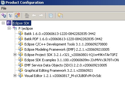

I have VE 1.2 and what I believe to be all of the latest versions of GEF,
EMF, Eclipse Build SDK etc. but I don't see SWT components, containers,
menus, or controls when attempting to use the VE...
Any ideas?

Originally posted by: richkulp.us.NO_SPAM.ibm.com
Use the New Visual Class Wizard to generate an SWT widget. This will
make sure that your project is configured correctly for SWT.
