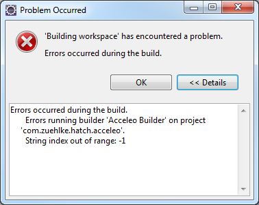

Hi Acceleo-Fans,
For quite some time, I encounter an annoying error during Acceleo builds inside eclipse. As a result, mtl-files are not compiled into emtl files correctly.
Does anyone have an Idea, why this happens from time to time?
Thanks and Cheers
Sergio
I'm running Acceleo 3.3.1 on Eclipse Juno
Here is the stacktrace:
java.lang.StringIndexOutOfBoundsException: String index out of range: -52

Re: [Acceleo] StringIndexOutOfBoundsException during Acceleo Build [message #933623 is a reply to message #932965] Fri, 05 October 2012 03:15 Go to previous messageGo to next message
Looks like a new problem; raise a Bugzilla.
