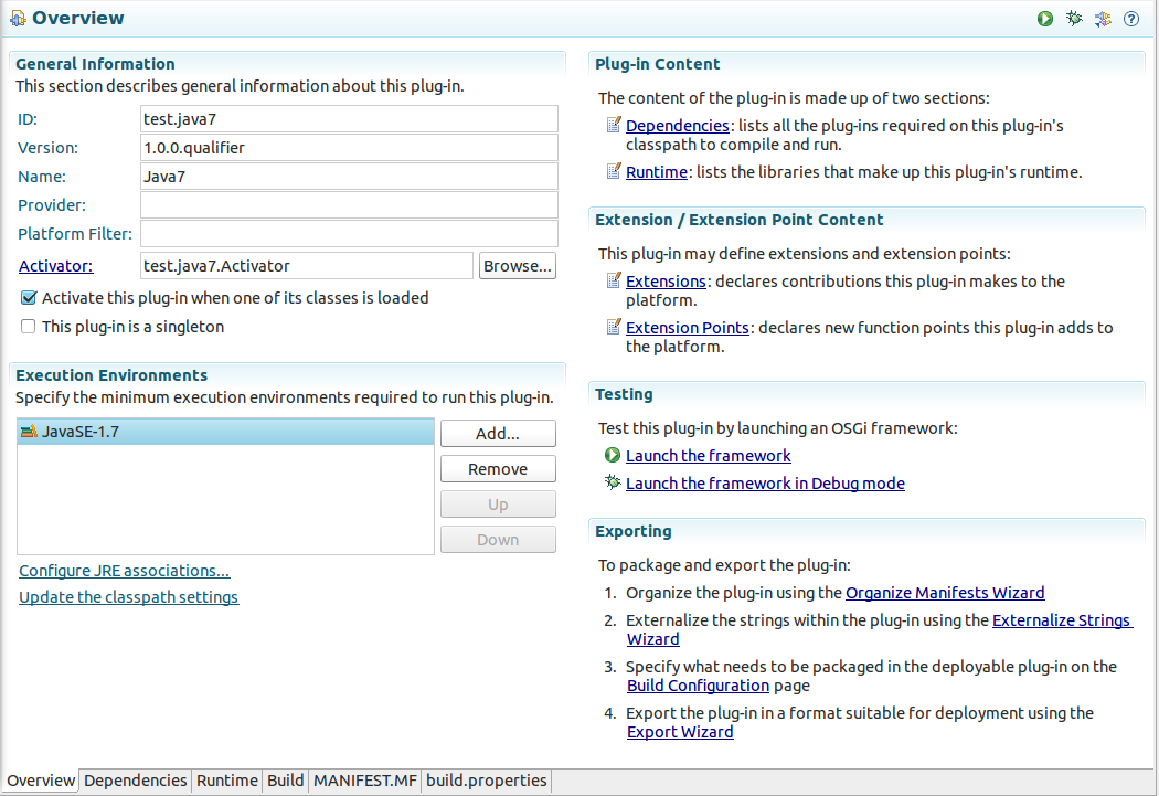

I verified that PDE and the WAR Product Tooling are able to build plugins using Java 7 source.
I think you are probably missing the OSGi Execution Environment. Open the plugin's manifest editor and verify that JavaSE-1.7 is listed under Execution Environments like this:
index.php/fa/11760/0/
With JavaSE-1.7 listed there it was able to build properly, but when I removed it the build failed with the same error you described.
Hope that helps,
Cole
Re: Java-Version of WAR product [message #936576 is a reply to message #934125] Mon, 08 October 2012 01:51 Go to previous messageGo to next message
No, as I said above the manifest contains the right Java version. It's funny, even the MANIFEST.MF inside the plug-ins inside the WAR still says "JavaSE-1.7", but the classes using actual Java 7 code are not compiled correctly.
