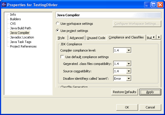

This is not enough. You need to change the source level (equivalent to
-source option in javac). By default javac 1.4 doesn't support the
assertion. You need to enable it with -source 1.4.
So if you go to Preferences>Java>Compiler>Compliance and Classfiles>
Uncheck use default compliance settings and put the values 1.4 for the
source level, 1.4 for the target and error for assert as identifier.
See my attached screenshot.

Re: assert, 3.0 M5 - settings.png (1/1) [message #124578 is a reply to message #124534] Thu, 04 December 2003 15:43 Go to previous messageGo to next message
Originally posted by: olivier_thomann.ca.ibm.comNOSPAM
  • Attachment: settings.png
    (Size: 16.26KB, Downloaded 98 times)
