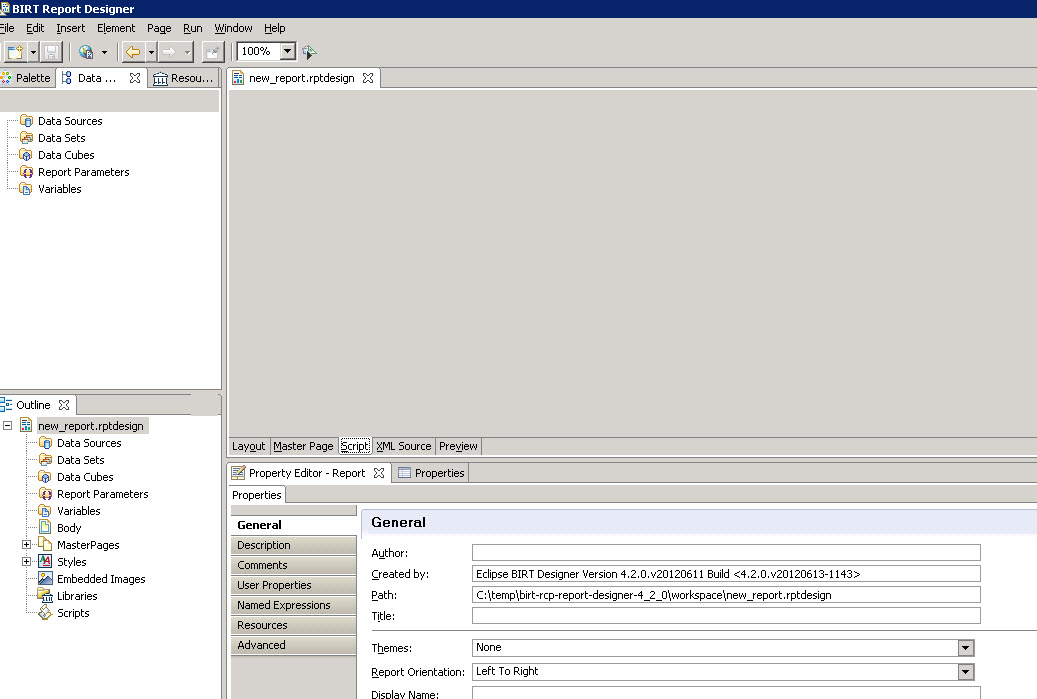

Dear all,
I recently created a sales order confirmation in Birt RCP report designer 3.7.1
This report runs fine in 3.7.1.
In this report, several scripts are embedded in the rptdesign.
Last month we started testing the same report on the 4.2.0 version of RCP designer. The designer runs after applying the intial bugfix as reported on this forum.
The sales-order-confirmation report loads with no errors in the designer and it runs even with executing the custom code.
Yet, when trying to open the script tab in the designer it will not display the code or not even the available events.
I tried both on win 32 bit version (server 2003) as on 64bit version (server 2008R2), same result.
After this, I tested to create/edit scripts for a brand new report (with no existing layout / script or other inheritance) with same result: the script editor tab can be selected, but nothing appears.
Am I missing something or is this to be considered as a bug?
Many thanks,
Stan
ps. I attached the screenprint of 4.2.0 on winserver2003, 32 bit /

I believe in the RCP version the script editor no longer shows. Can you try the all in one download? BTW I checked bugzilla and it appears no one has reported this. The original design I believe was to disable the script view in the RCP designer, but I do not think this was implemented in earlier versions of BIRT. Can you open a bugzilla entry for this?

I downloaded the all in one version.
In the all-in-one version the birt report script tab does allow to select events or add code.

Today installed "birt-rcp-report-designer-4.2.1RC3.zip"
This resolved the issue.
