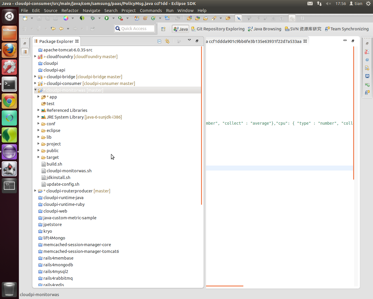

Please check this pic.
Some projects I import from git has simple ">" in front of project name.
I can use every function of egit in this poject
Some projects has simple "*" in front of project name.
I can not use most of function of egit in this poject.such as show history,pull,push.
Please help me,thanks

Re: Weird Simply in front of project name,I can not use some egit funtion s [message #908819 is a reply to message #908496] Thu, 06 September 2012 00:04 Go to previous messageGo to next message
version is eclipse juno Version: 4.2.0
When I use "pull"
the error is
/plugins/com.aptana.git.core_3.0.0.1342049701/os/linux/ssh-askpass.tcl: 3: exec: wish: not found
Permission denied (publickey,gssapi-keyex,gssapi-with-mic,password).
fatal: The remote end hung up unexpectedly
When I use "show in history" the content of window is empty
When I use "push",the error is
those projects are in the same server,I don't think is the account or network problem.cause I can use git cmd to do those actions
Re: Weird Simply in front of project name,I can not use some egit funtion s [message #908878 is a reply to message #908819] Thu, 06 September 2012 02:56 Go to previous message
com.aptana.git.core is not part of EGit. You seem to have installed another git plugin coming from aptana studio. You can see in the screenshot that the projects with the strange decorator also have a different text decorator, it only shows the branch but not the repository name. So I think the projects with ">" are shared with EGit, but the two erroneous one with "*" with the other Team Provider.
