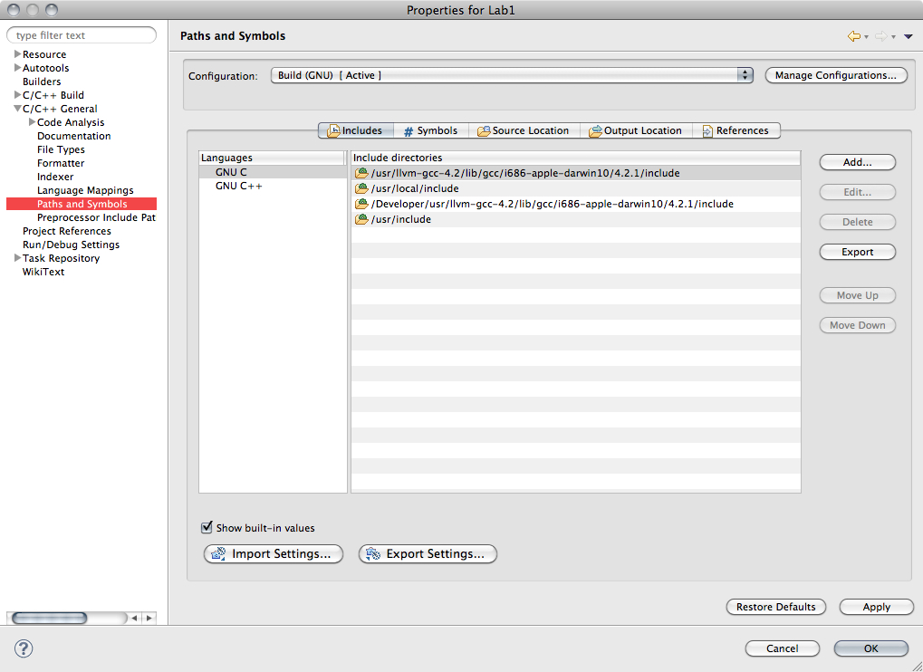

Re: Library Paths tab missing?? [message #910425 is a reply to message #908139] Sun, 09 September 2012 12:20 Go to previous messageGo to next message
The library and library path tabs are missing in my Juno on OSX 10.6.8. See screen capture.
Re: Library Paths tab missing?? [message #910427 is a reply to message #908286] Sun, 09 September 2012 12:23 Go to previous messageGo to next message
I just submitted a response to the originator of this topic with a screen capture. I am not able to see the Libraries or Library Path tabs in Juno on OSX. Interestingly, they show up on a c++ project that I created with Helios, but when I created a new project, the tabs weren't there.
