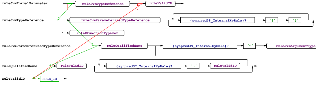

I have a simple little grammar which keeps giving a multiple alternatives error when I try to generate Xtext artefacts.
The grammar is:
grammar org.xtext.example.hyrule.HyRule with org.eclipse.xtext.xbase.Xbase
generate hyRule (You can only use links to eclipse.org sites while you have fewer than 25 messages )
Start:
	rules+=Rule+
Rule:
	'FOR''PAYLOAD'payload=PAYLOAD'ELEMENTS' elements+=JvmFormalParameter+'CONSTRAINED' 'BY' expressions+= XExpression*;
PAYLOAD:
	"Stacons"|"PFResults"|"any"
And the exact error I get is:
warning(200): ../org.xtext.example.hyrule/src-gen/org/xtext/example/hyrule/parser/antlr/internal/InternalHyRule.g:3197:2: Decision can match input such as "{RULE_ID, '=>', '('}" using multiple alternatives: 1, 2
As a result, alternative(s) 2 were disabled for that input
error(201): ../org.xtext.example.hyrule/src-gen/org/xtext/example/hyrule/parser/antlr/internal/InternalHyRule.g:3197:2: The following alternatives can never be matched: 2
I have attached the Syntax diagram for the generated antlr grammar in antlrworks, and can clearly see the multiple alternatives(JvmFormalParameter can match RULE_ID via the JvmTypeReference or the ValidID rule).
So it looks as if JvmFormalParameter is ambiguous...Apologies for my stupidity but could someone point out what it is I'm missing? Is there some way of overcoming this ambiguity when using the JvmFormalParameter rule in my grammar?

Solution Courtesy of Sebastian Zarnekow:
Problem solved by using a delimiter, for example elements+=JvmFormalParameter (',' elements+=JvmFormalParameter)*
