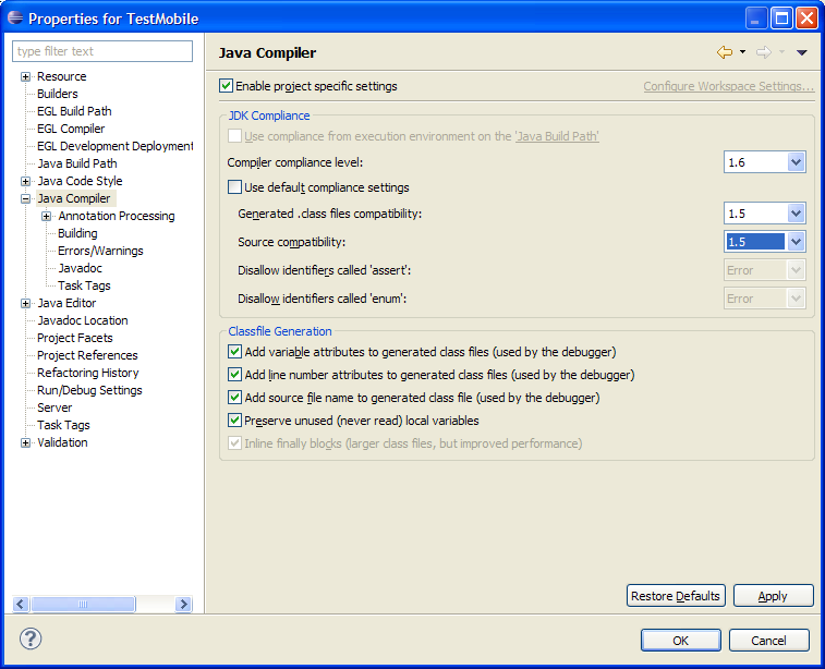

Set your compliance level as shown in the attached screen shot. You'll do this on the deployed project -- not the EGL project.
There is no need to install a back-level JDK/JRE. You are just using a feature of the 1.6 compiler to compile to a back-level.
This technique worked for me until I recently brought the IBM i server up to 1.6. I'm not sure that everything generated out of EDT is still 1.5 compatible (or, if it is, will it be next week or next month?). It would be a good idea to get your IBM i runtime up to 1.6.
--Dan
