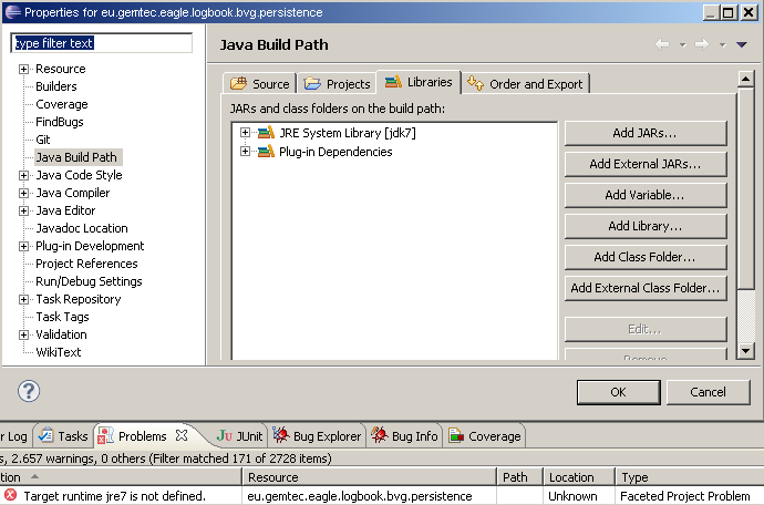

I got a error icon on one of our projects. The Problem-View shows "Faceted Project Problem: Target runtime jre7 is not defined.".
How can i solve the problem ? JRE7 is configured for my workspace, so i have no clue what the problem is.

The build path was set to JDK6, now i changed it to workspace default JDK7 (Project Properties|Java Build Path| Libraries|Edit|Workspace Default), but the problem remains.
Btw. my project got no property page called "Targeted runtimes" (maybe because it's an Plugin-Project?).
http://www.eclipse.org/forums/index.php/fa/11313/0/
