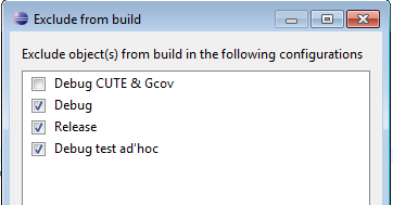

Thanks Andrew. "Reset to Default" is grayed out in my Eclipse instance. The other option worked though. But I've noticed that the file status (and icon) is dependent solely on the first checkbox below
index.php/fa/11245/0/
meaning that whether checkboxes other than the top checkbox are ticked or not doesn't affect the file's status as "excluded from build".
Is it normal? I would have thought that the view would refresh according to the active build configuration. What do you think?
Re: CDT UI - What does this icon mean? [message #902852 is a reply to message #902829] Mon, 20 August 2012 14:08 Go to previous messageGo to next message
CDT editor and Explorer reflect not active build configuration but configuration which is being indexed. See also https://bugs.eclipse.org/bugs/show_bug.cgi?id=313944.
Andrew
