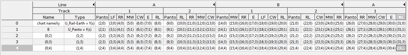

Re: addColumnsIndexesToGroup [message #902646 is a reply to message #902645] Thu, 16 August 2012 11:43 Go to previous messageGo to next message
The DisplayConverter works now, see the picture and coresponding code below:
natTable = new NatTable(sashForm_1, gridLayer, false);
natTable.addConfiguration(new DefaultNatTableStyleConfiguration());
natTable.getConfigRegistry().registerConfigAttribute(CellConfigAttributes.DISPLAY_CONVERTER,
new DisplayConverter() {
public Object canonicalToDisplayValue(Object canonicalValue) {
if (canonicalValue instanceof String) {
String[] lStrings = ((String) canonicalValue).split("/");
if (lStrings.length > 2) {
return lStrings[lStrings.length - 1];
return canonicalValue;
public Object displayToCanonicalValue(Object displayValue) {
return displayValue;
}, DisplayMode.NORMAL, GridRegion.COLUMN_GROUP_HEADER);
natTable.configure();
Martin
