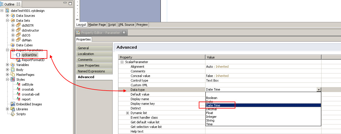

Good question... let me see if I can be a li'll more specific.
the report parameter is rpStartDte.
the new version on the lms require that date parameters be dateTime (birt) format as opposed to the old way date (birt) format.

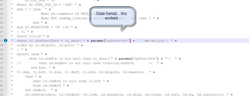

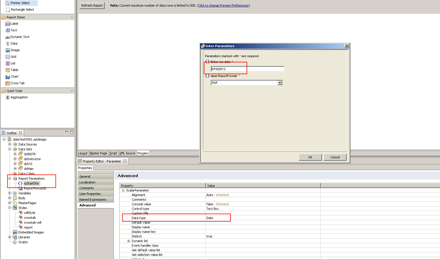

1. Example one works (report parametere is Date.
The old way using Date format report parameter works in my property binding, ex.
" where r2.chkStartDate = to_date('" + params["rpStartDte"] + "','mm/dd/yyyy') " +

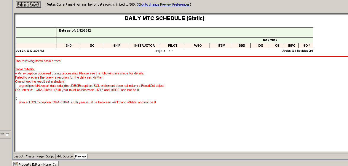

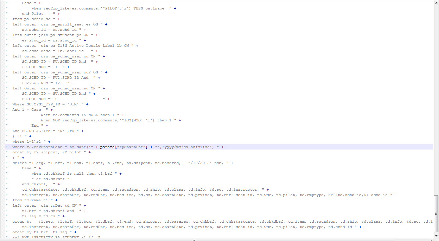

2. This doesn't work, mainly because I don't know how to format map dateTime, ex.
report parametere is DateTime:
" where r2.chkStartDate = to_date('" + params["rpStartDte"] + "','mm/dd/yyyy hh:mi:ss') " +
how can I get #2 to work? I'm getting datetime format errors.
I'm using BIRT 2.6.1 and Oracle 11g
Some of errors I'm getting.
java.sql.SQLException: ora-01841: (full) year must be between -4713 and +9999, and not be 0.
or if i change the datetime map, i'll get "invalid month".
