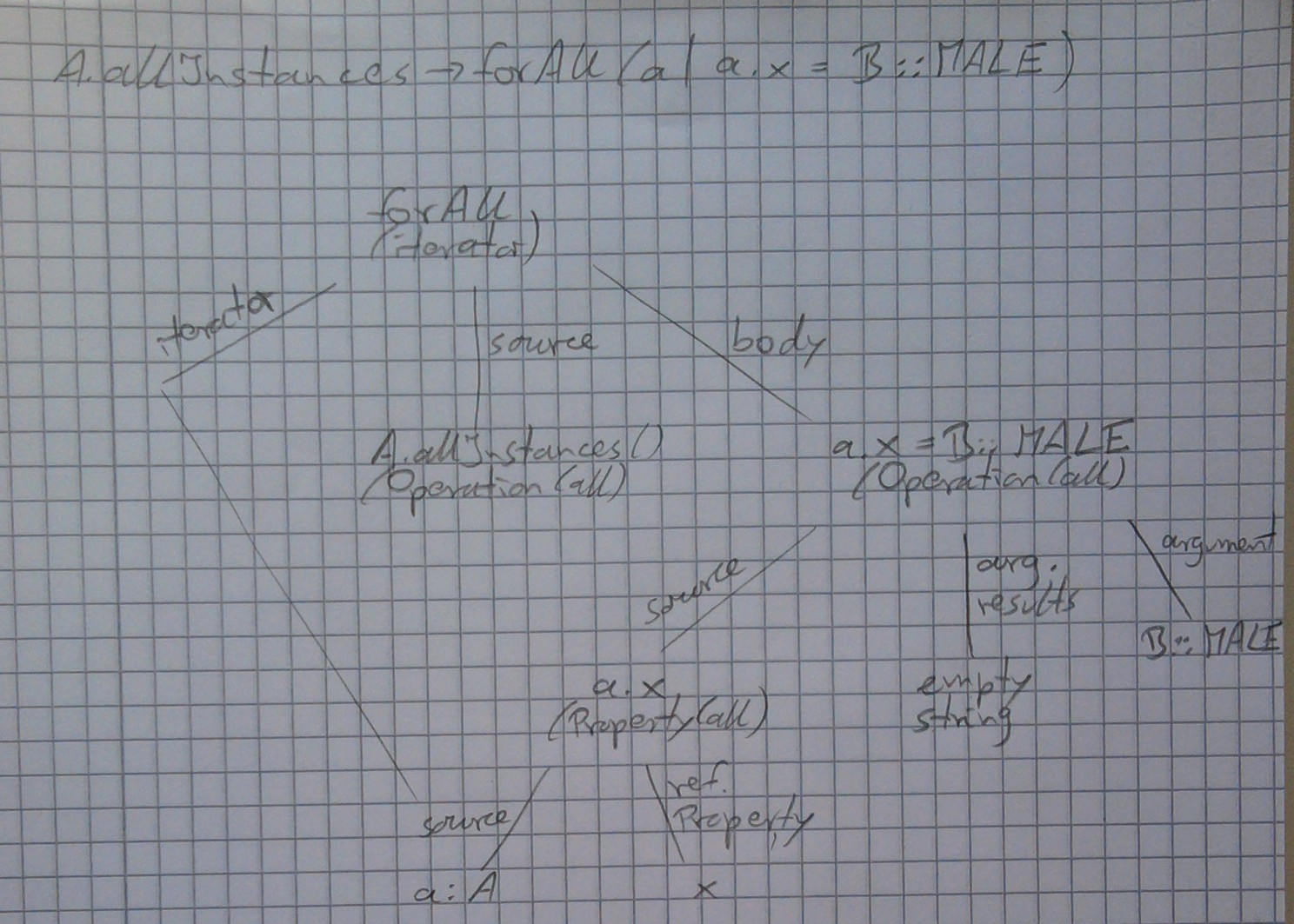

when processing the Abstract Syntax Tree with AbstractVisitor I want to know if the current parsed part is the body of an overlying expression. To make it more clear, I have uploaded an example of a syntax tree. Referring to the example:
when parsing the equality operator a.x = B::MALE (this happens in the overriden handleOperationCallExp()) I want to know if this expression is the body (or source etc.) of another expression (in this case: forAll)

Re: processing AST, finding out if current parsed part is the body of the OCL expression [message #901205 is a reply to message #901198] Fri, 10 August 2012 06:27 Go to previous messageGo to next message
If you use the new Xtext Pivot-based OCL, you can experiment in the OCL
Xtext Console.
self.oclType().ownedAttribute() will list all properties.
self.oclContainer() will find the container.
self.oclContainer()->selectByKind(LoopExp)->exists(body = self)
but your query is vague so perhaps just
self.oclContainer().oclIsKindOf(OCLExpression) wil do
If you use the old Ecore binding, similar things can be achieved with
eClass() and eContainer().

Thank's, I'm using eContainingFeature() now and it works.
