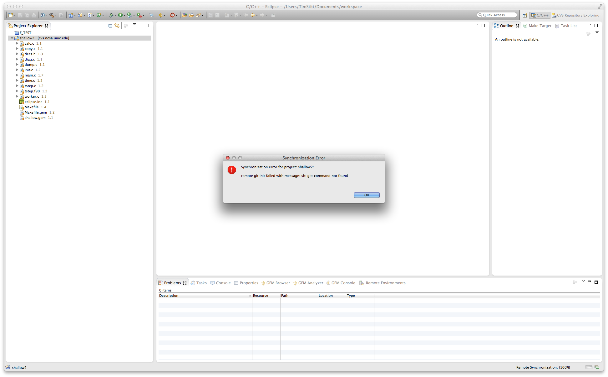

I'm new to Eclipse and was trying out a tutorial on the Parallel Tools Platform given at a recent supercomputing conference. I followed the tutorial to check out a project via CVS and then tried to synchronize it on a remote server.
When I try the synchronization step I get a "remote git init failed: sh: git: command not found" (see attachment). I know that git is not installed by default on our remote cluster, so I was wondering if there was a way around this (I doubt the administrators will change their default software stack to enable git). Can I change the synchronization method to something else e.g. svn?

Hello everyone,
I am following up on the issue that Tim mentioned with our cluster. I tried the suggested approach, but it did not work. Also, it seems the the correct Team > Share Project setting was selected from the beginning. Does anyone else have anymore suggestions on how to do a remote synchronization succesfully since we do not have the git command? If anyone needs anymore information, fee free to ask. Also, I would like to add that the files we are trying to synchronize are not our own, they are from a tutorial located in the following site: http://wiki.eclipse.org/PTP/tutorials/XSEDE12. Also, as mentioned earlier, we are new to using eclipse so I apolgoize if what I mentioned is irrelevant.
