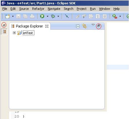

I want to hide the two restore buttons (circled in red in the screen shot) for my own Part.
index.php/fa/11090/0/

That type of behaviour is handled by the MinMaxAddon, contained in org.elipse.e4.ui.workbench.additions.swt. You can either roll your own or hack up the existing one to add the flexibility as to be configurable to handle your situation as well. You should create a bug to track any discussion at:
https://bugs.eclipse.org/bugs/enter_bug.cgi?product=Platform&component=UI&version=4.2&bug_severity=enhancement
