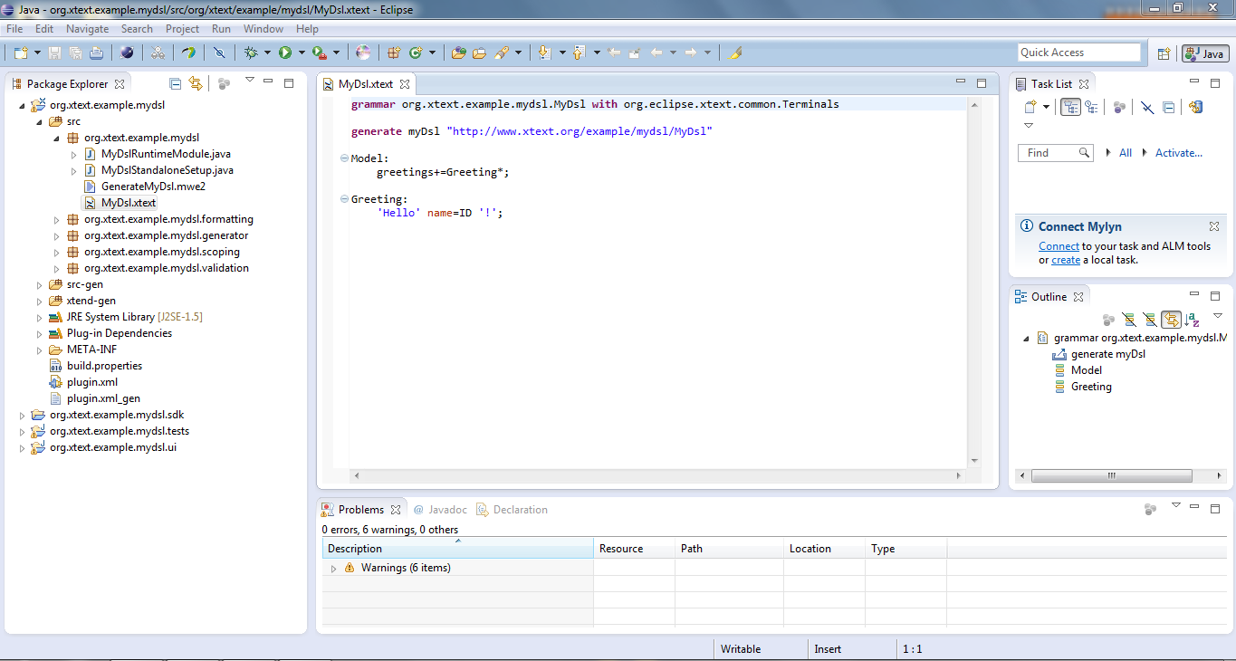

1- Create your sample grammar in Xtext with the 5 minute tutorial (Cattura.png)

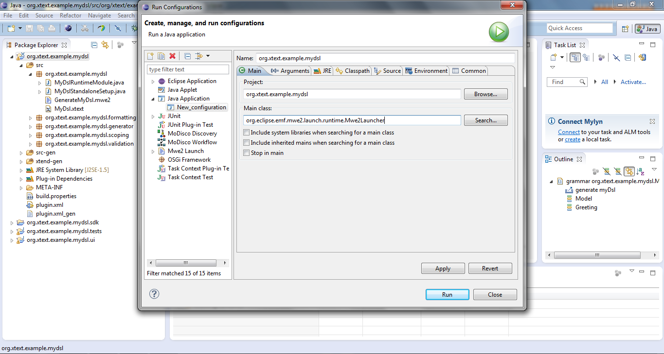

2- Create a run configuration for the project (Cattura1.png)

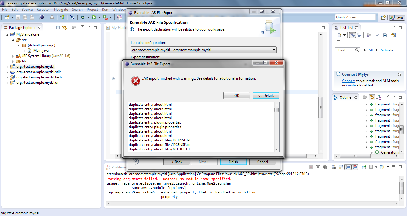

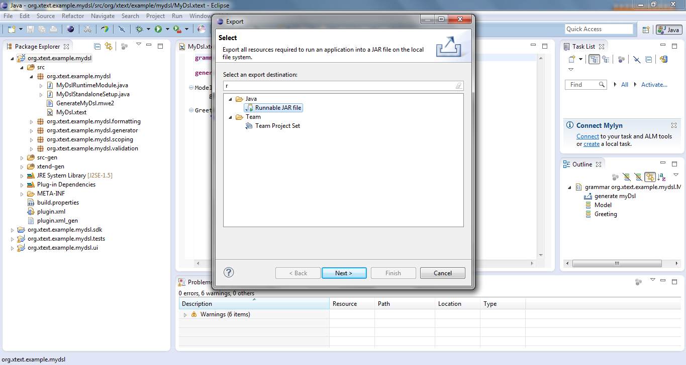

3- Export the project as a runnable jar in the lib folder of your standalone project (Cattura2.png+Cattura3.png)
4- I got warnings and incomprehensible stuffs, but it works even with them (Cattura4.png)

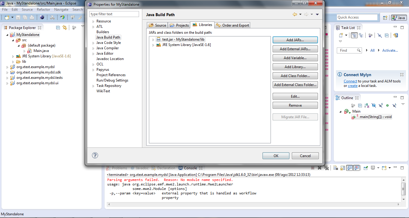

5- Add the jar to your standalone project (Cattura5.png)
