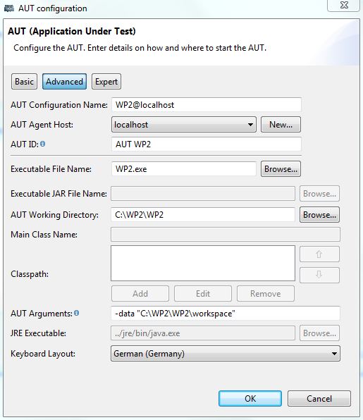

Re: AUT starts but not recognized by Jubula [message #1005398 is a reply to message #900043] Fri, 25 January 2013 04:05 Go to previous messageGo to next message
Thank you for you response.
I have tried the AUT configuration with using the -data option in the AUT Arguments, without results...
When I click "start AUT" button the login screen pop up, but the the "Running AUTs" is empty.
The "Start AUT Agent" show me this Error just after the Log-In:
"AUT:Error while painting table: java.lang.ArrayIndexOutOfBoundsException: -1"
The RCP application was created with e4...
The file directory for the plugin:
C:\WP2\WP2\plugins
The config.ini file
osgi.bundles=WP2,\
  ca.odell.glazedlists,\
  ch.qos.logback.classic,\
  ch.qos.logback.core,\
  com.ibm.icu,\
  org.eclipse.m2e.logback.appender,\
  org.eclipse.swt.win32.win32.x86,\
  org.eclipse.ui.win32,\
  org.eclipse.jubula.rc.rcp
And the AUT configuration:
index.php/fa/13083/0/
[Updated on: Mon, 28 January 2013 03:35] by Moderator
Re: AUT starts but not recognized by Jubula [message #1005948 is a reply to message #1005398] Tue, 29 January 2013 06:34 Go to previous message
Just found the relevant line in your last post: the currently released version does not support e4 applications yet. We are working on it, and there is an open ticket that documents our progress and people's interest. I imagine we'll be updating it with our latest status in the next couple of days, so you might want to add yourself to the cc list.
