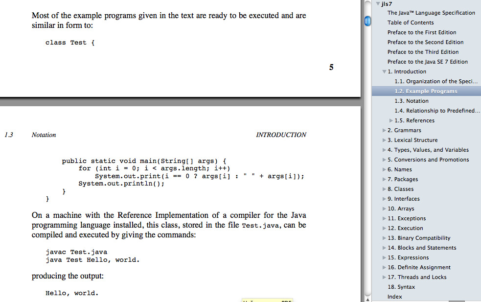

How do I do this in eclipse (like on pic)?
EDIT: I mean these two :
javac Test.java
java Test Hello, World.
How do I do this? :/

From the context menu of the *.java with the main, you can invoke Run
As -> Java Application. If you want to specify arguments, you can use
Run -> Run Configurations... to specify them via the Java Application's
run configuration.

Re: How do I do this? [message #899833 is a reply to message #899726] Thu, 02 August 2012 09:55 Go to previous messageGo to next message
Here's what I got!
Exception in thread "main" java.lang.NoClassDefFoundError: javac
Caused by: java.lang.ClassNotFoundException: javac
at java.net.URLClassLoader$1.run(URLClassLoader.java:202)
at java.net.URLClassLoader.findClass(URLClassLoader.java:190)
at java.lang.ClassLoader.loadClass(ClassLoader.java:306)
at sun.misc.Launcher$AppClassLoader.loadClass(Launcher.java:301)
at java.lang.ClassLoader.loadClass(ClassLoader.java:247)
I put this in the VM thing. In the program thing it just pasted the code and did nothing at all
Re: How do I do this? [message #899887 is a reply to message #899833] Thu, 02 August 2012 13:31 Go to previous messageGo to next message
You mean the VM arguments in the Run Configuration? You'd specify your
arguments for main in the Program arguments section.
On 02/08/2012 3:55 PM, Edward Rech wrote:
> Here's what I got!
> at java.security.AccessController.doPrivileged(Native Method)
Re: How do I do this? [message #900412 is a reply to message #899833] Mon, 06 August 2012 18:09 Go to previous message
Edward Rech wrote on Thu, 02 August 2012 09:55
Here's what I got!
When using Eclipse you do not have to invoke javac Test.java yourself. Javac is the standard command line java compiler. In Eclipse you either check 'Build Automatically' in the Project menu OR you choose 'Build Project' OR you right-click the project name and choose 'Build Project'. That will compile your java code into classes and place it in a hidden bin folder in your project tree. Then to run the program you can right click the project and choose 'Run-As' -> Java application. That is the equivalent of the command line command 'java Test'. Note that if you have 'Build Automatically' checked then those 'Build Project' options will be greyed out or missing.
To run your test program with the arguments Hello, World you can use the Run menu 'Run-configurations' choice to 1) create a new java application config, 2) put Hello and World in to the program arguments dialog, 3) Run
