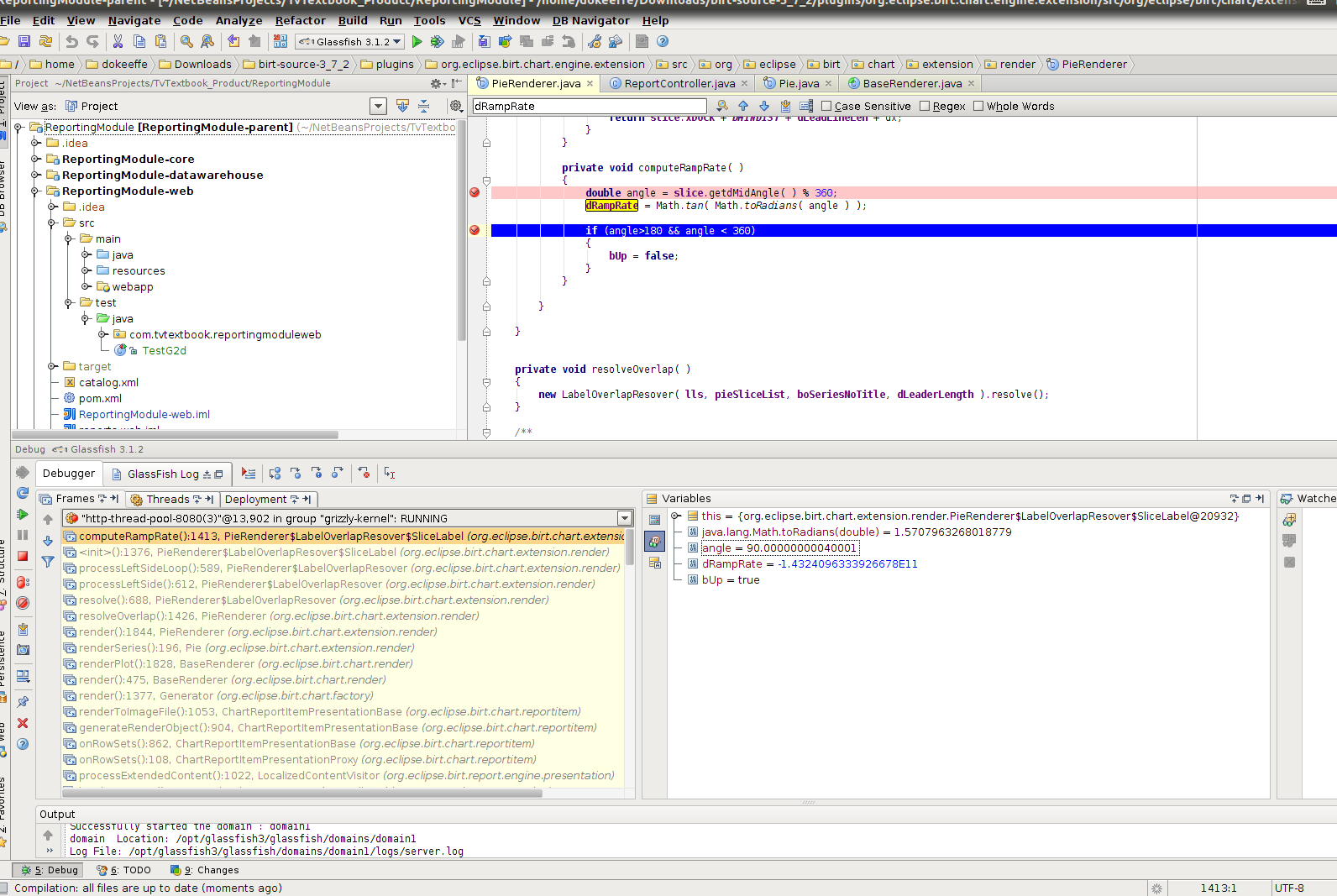

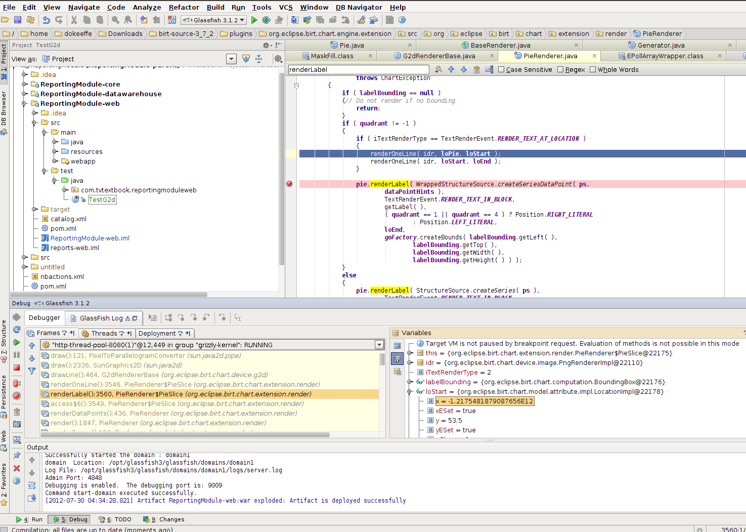

Re: BIRT Engine and server doesn't respond [message #899140 is a reply to message #899125] Mon, 30 July 2012 12:18 Go to previous messageGo to next message
Hi Jason,
We are now debugging the birt source and looks like birt gets into a infinite loop.
One of the slices in the pie chart has an loStart with an x value of -1.2175^E12 which is a very large -ve number.
This value gets passed into java2d's MaskFill class method FillAAPgram and appears to hang in here and never return.
See the screeshot attach.
The report is attach.

Re: BIRT Engine and server doesn't respond [message #899147 is a reply to message #899140] Mon, 30 July 2012 12:30 Go to previous messageGo to next message
Ricardo,
If you remove the chart scripts do you get this error. It looks like
something is wrong with the loStart location as you have seen. I would
like to figure out if the plot calc engine has a bug.
Jason

Re: BIRT Engine and server doesn't respond [message #899264 is a reply to message #899154] Tue, 31 July 2012 05:14 Go to previous messageGo to next message
Jason,
Debugging addSliceLabel()
I see the getXStartClosestToPie() method uses a number from label_list.get(0).getXStartClosestToPie( y );
Now this first element in the list is a SliceLabel with a dRampRate of -1.4^11.
The angle by sheer bad luck was 90.0000000000040001 degrees
The tan of 90 is infinity and we are close to this number.
See screenshot attach.
I replicated this bug with BIRT 4.2.
We need to garantie that this won't happen again and specially that Birt doesn't get in a loop and breaks the server.
Can you garantie that if we define the coverage to auto, or a specific value for the rotation, or anything else, this won't happen again?
Or could you guys create a quick fix for this? ... even throwing an exception avoiding the loop would be enough for us.

On 7/31/2012 5:14 AM, Ricardo Rodrigues wrote:
> Jason,
> Our Suggested Solution:
> private void computeRampRate( )
> double angle = slice.getdMidAngle( ) % 360;
> if(angle%90 < TAN_INFINITY_THRESHOLD || angle%90 <
> TAN_INFINITY_THRESHOLD) {
> angle = angle - 1; //subtract 1 degree if close to 90 or
> 270 as this will result in a very very large number like 1.4^12
> dRampRate = Math.tan( Math.toRadians( angle ) );
> if (angle>180 && angle < 360)
> bUp = false;
> Thank you
