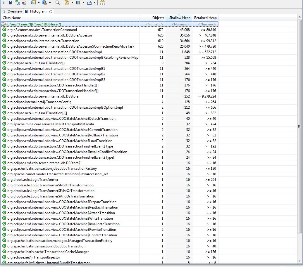

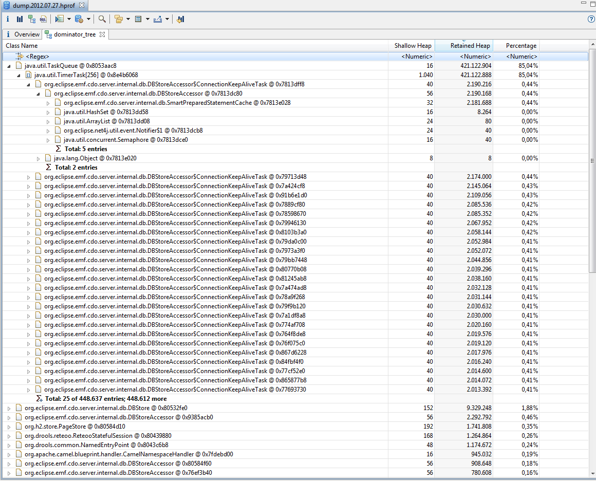

On my server I have after some days 3637 instances from the class 'org.eclipse.emf.cdo.server.internal.db.DBStoreAccessor' and some of these contain/reference alot of data. The mat - MemoryAnalyzer tells me that these instances contain/reference 350MB of data.
There are only 2 CDOSessions open to the CDOServer, one client is in the same VM and the other client is operating remote. The CDOClient on the server is doing alot transactions and queries, but all in one thread.
These classes have same instance count (in the CDOServer VM):
org.eclipse.emf.cdo.server.internal.db.DBStoreAccessor$ConnectionKeepAliveTask
org.eclipse.emf.cdo.server.internal.db.SmartPreparedStatementCache
(The instances are connected to 'java.util.TimerTask')

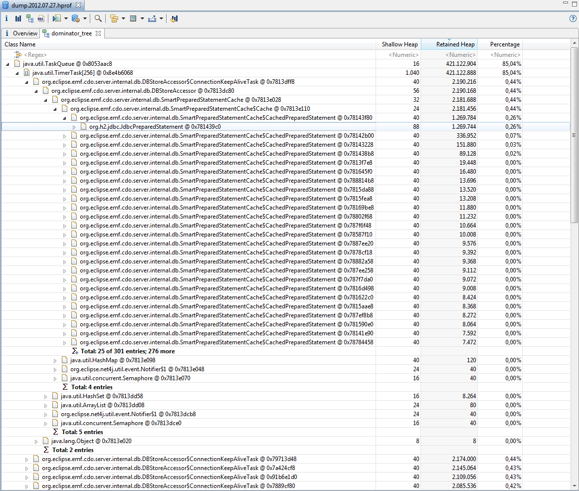

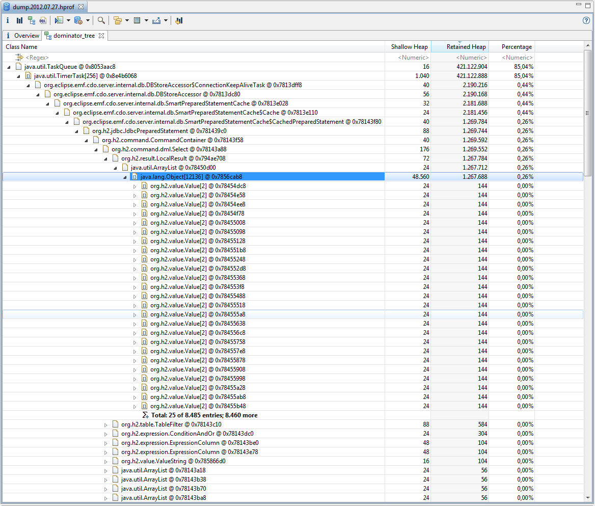

The 'SmartPreparedStatementCache' seems to contain the biggest amount of data.
For now I can't reproduce it in a simple testcase Sad
Are about 3600 instance from the class 'DBStoreAccessor' to much?
To search/identify the leak, I have set the h2-cache to a low value and I have disabled the the RevisionManagerCaching for the CDOServer and the CDOClient. Can I do more or should I try something else?

What do you mean by "connected"? Do you have a screenshot from MAT?

I have attached 3 screenshots.

I think a smarter cleanup of the pool would solve our problem (screenshots)?

Re: [CDO] DBStoreAccessor, SmartPreparedStatementCache [message #899241 is a reply to message #898594] Tue, 31 July 2012 04:21 Go to previous messageGo to next message
Bug report/enhancement: https://bugs.eclipse.org/bugs/show_bug.cgi?id=386289
Re: [CDO] DBStoreAccessor, SmartPreparedStatementCache [message #900530 is a reply to message #898594] Tue, 07 August 2012 08:12 Go to previous messageGo to next message

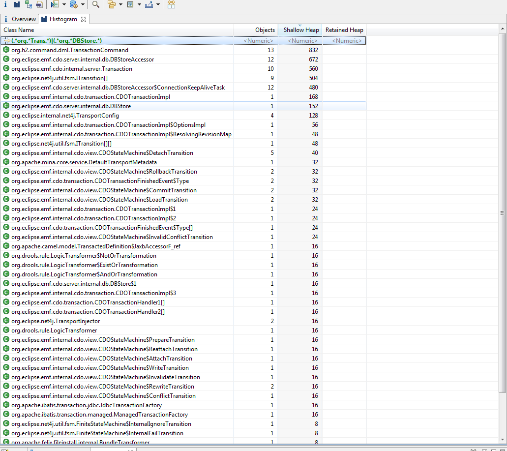

Hello again,
In our system I modified the cdo server to use the 'org.eclipse.emf.cdo.server.internal.db.NullPreparedStatementCache'.
Then I let it run.
1. At the beginning after a lot queries the Memory looks like this (mat_001_startup.png) (server and one client run in the same VM)
2. After some time (a lot of queries and commits) it looks like this (mat_002.png).

Re: [CDO] DBStoreAccessor, SmartPreparedStatementCache [message #900568 is a reply to message #900530] Tue, 07 August 2012 10:54 Go to previous messageGo to next message
Hi Per,
This is a follow-up effect of the store accessors being pooled but never released in phases of low load.These
transaction must be inactive but still referenced via StoreAccessorBase.context.
Cheers
/Eike
http://www.esc-net.de
Am 07.08.2012 14:12, schrieb Per Sterner:
> Hello again,
> Then I let it run.
> In my logfile there were many exceptions like this:
> org.eclipse.net4j.signal.RemoteException: org.eclipse.net4j.util.om.monitor.MonitorCanceledException: org.eclipse.net4j.util.concurrent.TimeoutRuntimeException: Timeout after 11040 millis
> at org.eclipse.net4j.signal.RequestWithConfirmation.getRemoteException(RequestWithConfirmation.java:141)

as Eike suggested i tried to look into the DBStoreAccessor, but i have still some questions.
As Per wrote the ConnectionKeepAliveTask is one of the classes not being cleaned up. So i wanted to ask if thats because the DBStoreAccessor is pooled? Is this task stopped when the Accessor gets removed from the pool?
I tried to comment this part(DBStoreAccessor.doActivate) out:
  protected void doActivate() throws Exception
    DBStore store = getStore();
    connection = store.getConnection();
    // connectionKeepAliveTask = new ConnectionKeepAliveTask();
    // long keepAlivePeriod = ConnectionKeepAliveTask.EXECUTION_PERIOD;
    // long keepAlivePeriod = 1000L * 60L;
    // Map<String, String> storeProps = store.getProperties();
    // if (storeProps != null)
    // String value = storeProps.get(IDBStore.Props.CONNECTION_KEEPALIVE_PERIOD);
    // if (value != null)
    // keepAlivePeriod = Long.parseLong(value) * 60L * 1000L;
    // store.getConnectionKeepAliveTimer().schedule(connectionKeepAliveTask);
    // TODO - make this configurable?
    statementCache = CDODBUtil.createStatementCache();
    statementCache.setConnection(connection);
    LifecycleUtil.activate(statementCache);
As result all classes were removed correctly and didn't leak(DBAccessor, etc.). So I got the feeling that this ConnectionKeepAliveTask prevents the DBStoreAccessor from being garbage collected? (or did i get something wrong?)
Second, i wanted to ask for some hints where to look for the "Pooling-Strategy". I found the pools itself but not how and where they are cleaned up.
Christian

Hi Christian,
Please note that I've resolved https://bugs.eclipse.org/386289 in the meantime. Please feel free to reopen if you have
additional suggestions ;-)
Cheers
/Eike
