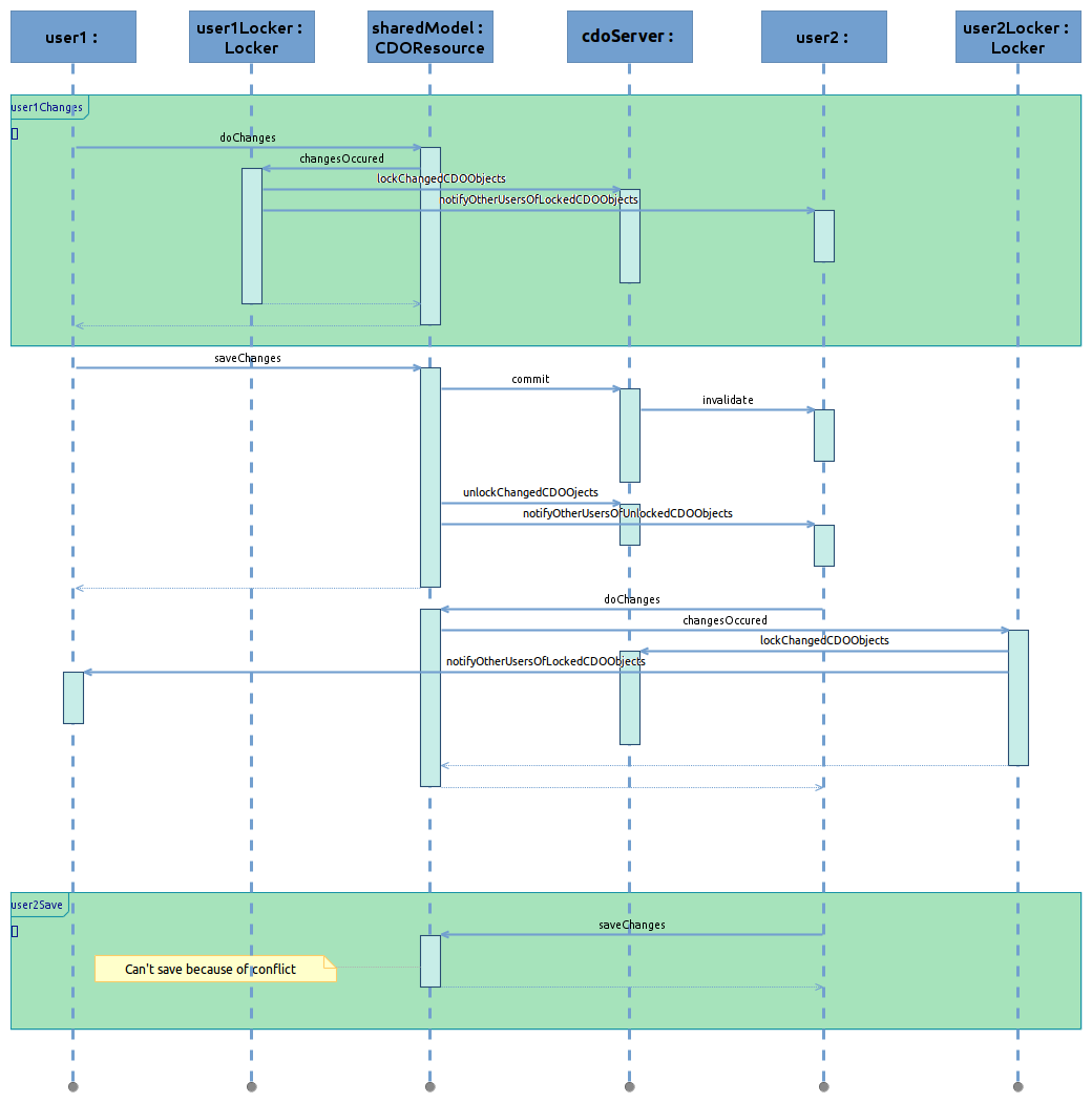

The attached screenshot2.png show the normal workflow.

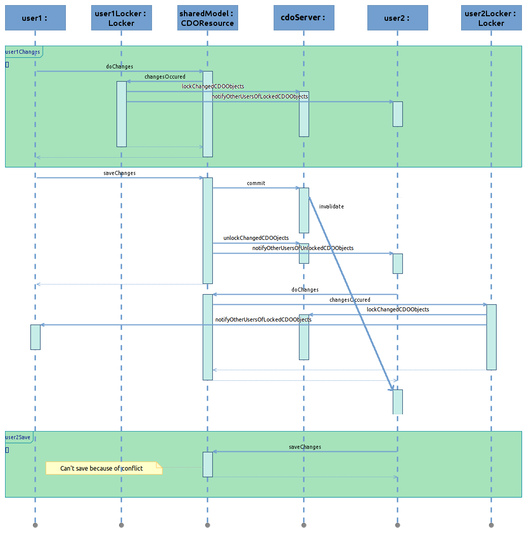

The attached screenshot.png show the conflicting workflow.
This last image show that on user2 the invalidation
(InvalidationRunnable) is executed after the unlock message reception
then between these 2 events user2 have the permission to do model
changes like the CDOObjects are unlocked. But during the
InvalidationRunnable execution, some conflicts are detected and can't be
resolved then at the end user2 can't save its shared resource (CDOResource).
