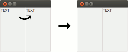

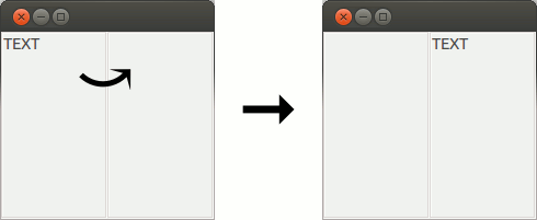

Yes, exactly. But I would like to have this behaviour:
  • If I had "TEXT" on the left side and "TEXT" on the right side, and I move the left text to the right side, the left text should disappear.

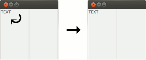

  • If I had "TEXT" on the left side and "" on the right side, and I move the left side to the left (source == target), the text should remain.

P.S.: My english is really awfull, so I show you my intention with pictures. I want to change the Snippet78.java so that the program has this behaviour:
  1. index.php/fa/10800/0/
  2. index.php/fa/10801/0/
  3. index.php/fa/10802/0/
