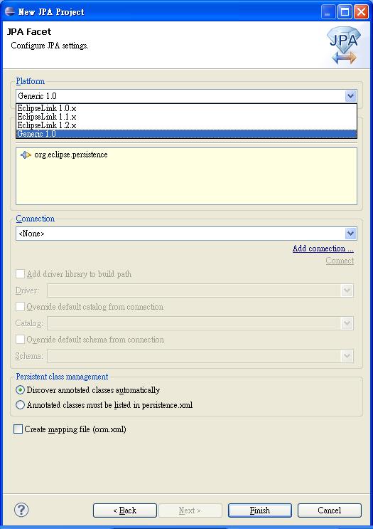

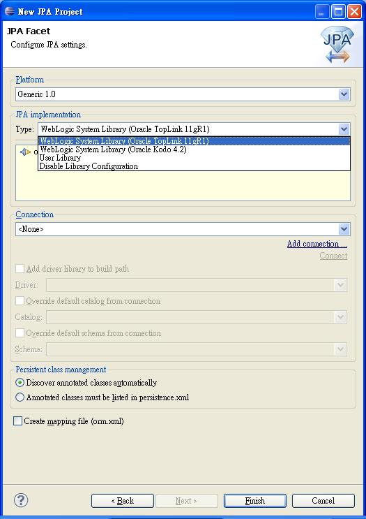

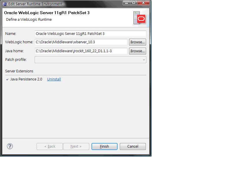

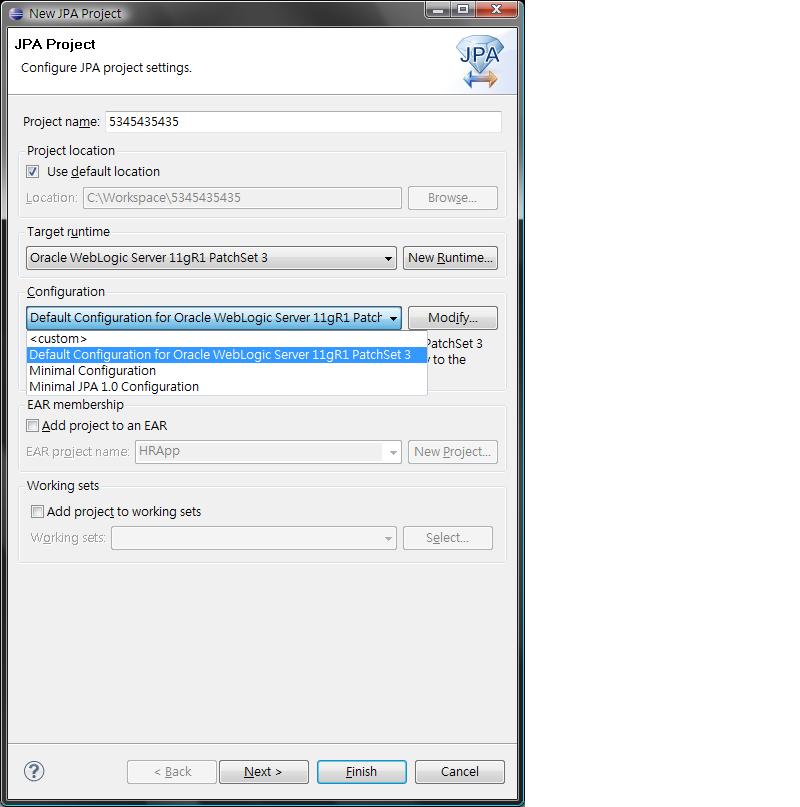

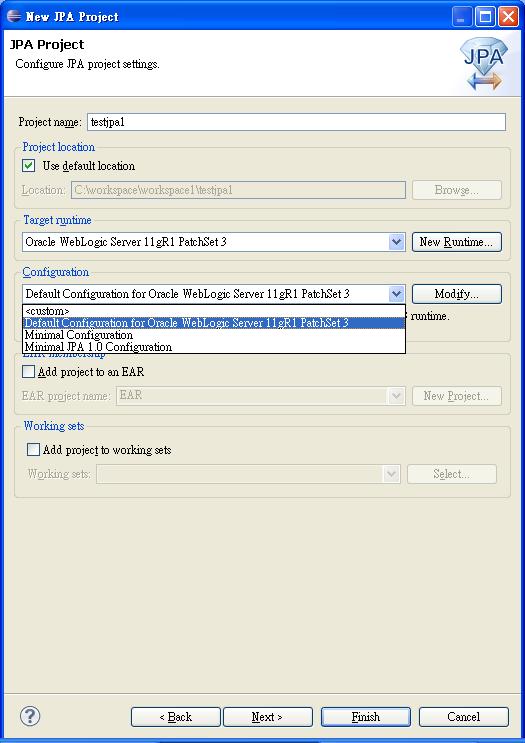

when I new a JPA project, select the platform, only 1.x is shown, why?
the sequence is attached as image 1-5.
In step 2, I select weblogic 11g as runtime, in step 3, I select default configuration for weblogic 11g, then in step 5, no eclipse 2.x is allowed to choose.
I know weblogic 11g (10.3.4) default is using jpa 1 but can manual enable to support jpa2, and I already manual enable it. But dali still not allow me to choose eclipselink 2.x in step 5, why?

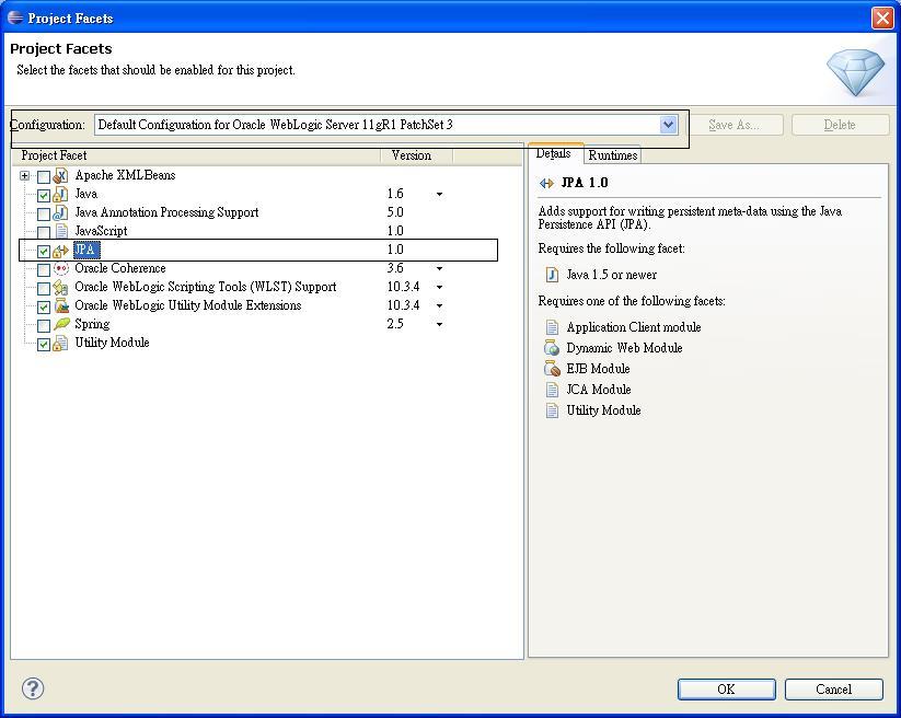

Re: cannot use eclipselink 2.x [message #896756 is a reply to message #896754] Thu, 19 July 2012 11:36 Go to previous messageGo to next message
Have you tried to click the "Modify..." button seen in screen shot 2 to change the JPA facet version to 2.0? By changing this setting, you should then be able to see the EclipseLink 2.x platform in step 5.

Re: cannot use eclipselink 2.x [message #896760 is a reply to message #896756] Thu, 19 July 2012 11:52 Go to previous messageGo to next message
as shown in attachment 3.jpg, click modify button, there is only three choice without "JPA facet version to 2.0".
the three choice shown in 3.jpg is
"default configuration for oracle weblogic server 11g..."
"Minimal Configuration"
"Minimal JPA 1.0 configuration"
Re: cannot use eclipselink 2.x [message #896800 is a reply to message #896760] Thu, 19 July 2012 16:30 Go to previous messageGo to next message
You need to actually click the "Modify...' button, as opposed to selecting one of the preset configurations in the drop down.

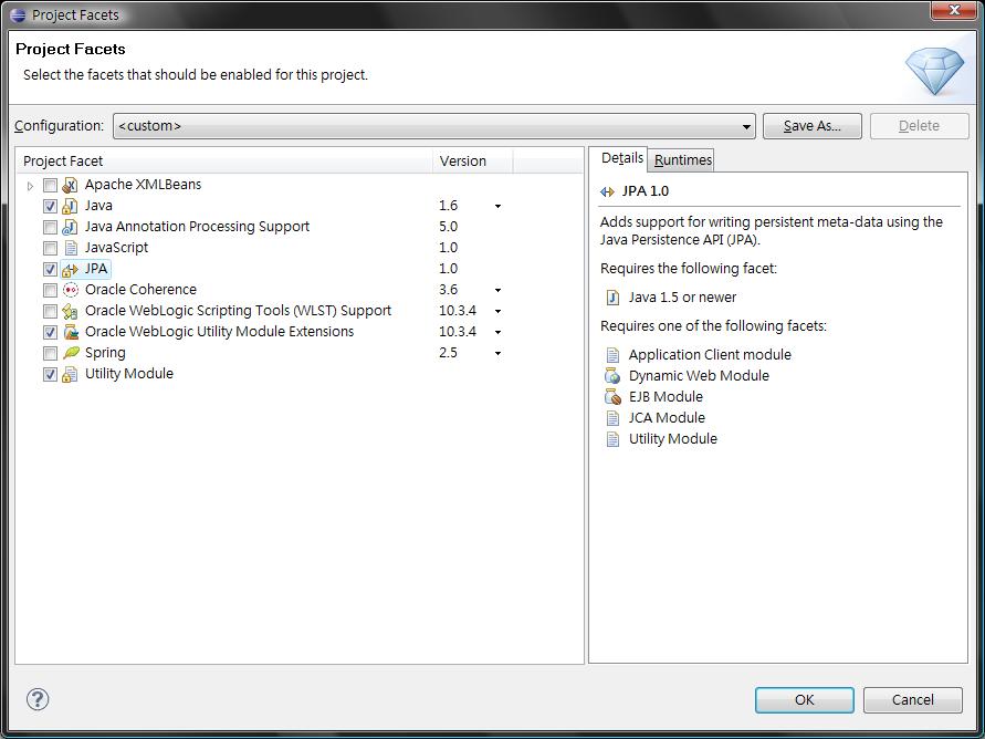

Re: cannot use eclipselink 2.x [message #896833 is a reply to message #896800] Thu, 19 July 2012 22:11 Go to previous messageGo to next message
sorry, I am very new to Dali and eclipselink.
After press the modify button, jpa6.jpg is shown, and there is still no jpa 2.0 to choose.

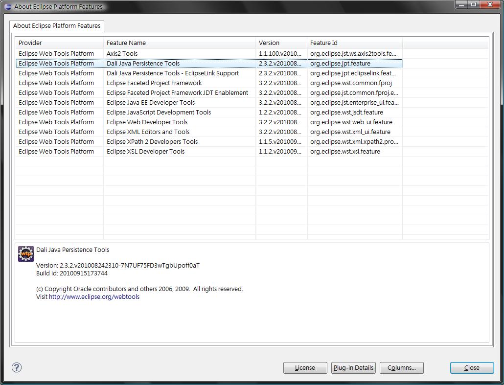

jpa7.jpg shown my current dali version.
in the link
http://docs.oracle.com/cd/E21764_01/web.1111/e13720/using_toplink.htm#CIHDGHFE
weblogic 10.3.4 should support jpa 2.0 after manual install the patch.

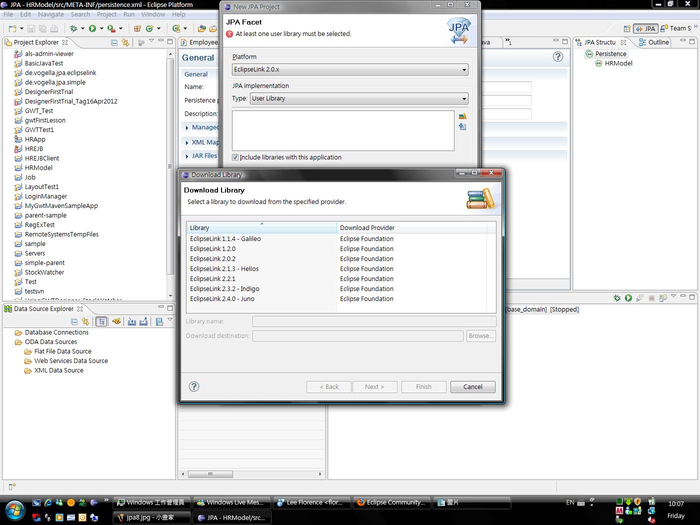

2)

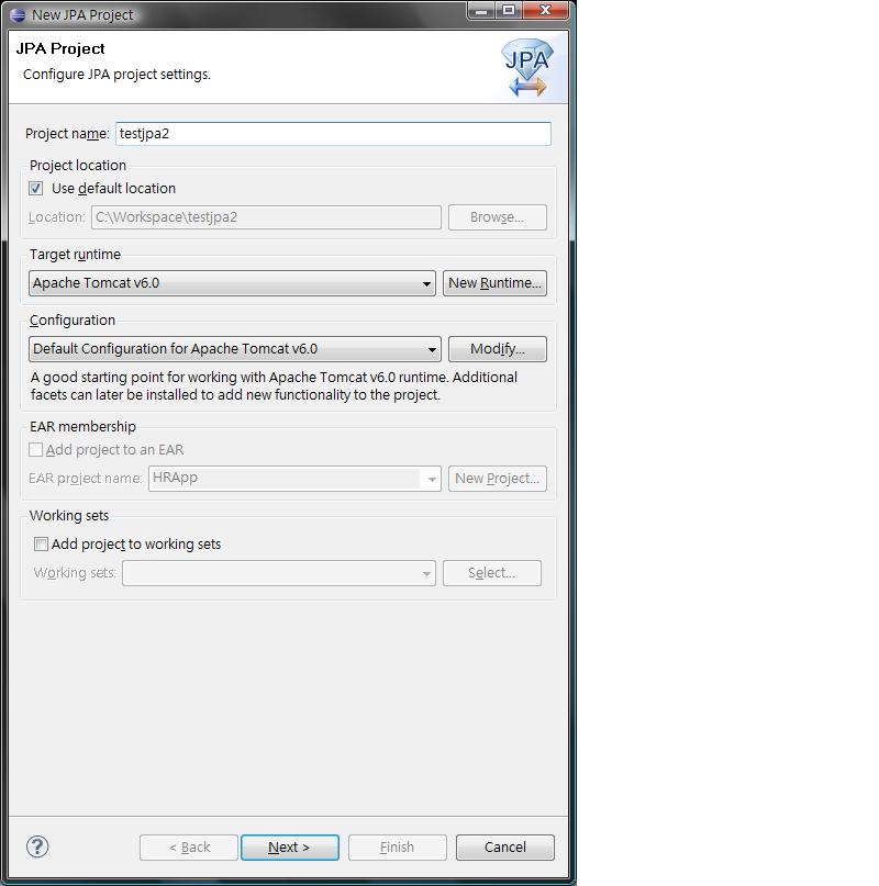

if choose tomcat 6.0 as the target runtime as shown in jpa8.jpg, then in platform (jpa9.jpg), I can choose Eclipselink 2.0.x, and in JPA Implementation, I need download Eclipse 2.1.3 if my eclipse version is Helios?
3)
Any tutorial for learning EclipseLink + Dali + JPA recommended?

Re: cannot use eclipselink 2.x [message #896948 is a reply to message #896754] Fri, 20 July 2012 09:48 Go to previous messageGo to next message
You actually need to change the version on the config screen in jpa6.jpg. It's a dropdown. This is separate from the manual enablement you've done to WebLogic. This tells the UI that you want to develop a JPA 2.0 compliant application.
Re: cannot use eclipselink 2.x [message #896966 is a reply to message #896833] Fri, 20 July 2012 11:10 Go to previous messageGo to next message
tong123123 tong123123 wrote on Thu, 19 July 2012 22:11
in the link
2)
3)
See Paul's comment regarding the version field. You are correct that WLS 10.3.4 will support JPA 2.0 after patching.
2) You should probably be basing your tooling needs around the version of EclipseLink that you need to use. Is there a reason you cannot move beyond the Eclipse Helios version? Helios is getting pretty old at this point.
3) The Dali website links to a number of How-To demos and also has a tutorial that may be helpful. The tutorial is somewhat out of date, but the concepts should be the same. Look on the right hand side of the screen for link to documentation, etc. http://eclipse.org/webtools/dali/
Re: cannot use eclipselink 2.x [message #896993 is a reply to message #896948] Fri, 20 July 2012 13:46 Go to previous messageGo to next message
the jpa version is not a dropdown, it does not allow modify and is 1.0.
as shown in jpa6.jpg and jpa10.jpg (new attached)

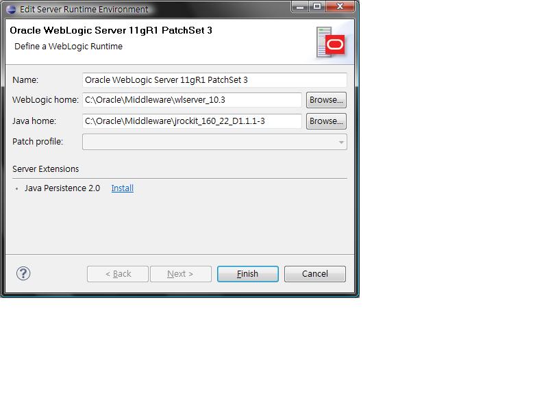

Re: cannot use eclipselink 2.x [message #897625 is a reply to message #897431] Tue, 24 July 2012 15:41 Go to previous messageGo to next message
Based on jpa13AfterInstall.jpg, I see that JPA 2.0 install is failing. Take a look at your Error Log view to see if there is anything interesting. You may also want to make sure that your WLS install folder is writable by whatever user you are running Eclipse under.

Re: cannot use eclipselink 2.x [message #898055 is a reply to message #897860] Wed, 25 July 2012 13:10 Go to previous messageGo to next message
I am referring to Eclipse Error Log view. Find it via Window -> Show View -> Other -> General -> Error Log. If you haven't used this view before, it will likely be littered with a lot of unrelated content. Clear its content and then try JPA 2.0 install again. What do you see?
Make sure that the server isn't running when you do this and that nothing else is locking weblogic.jar or making it unnaccessible. Try renaming weblogic.jar. Did that work?
If you keep having problems with this, you may need to reinstall WLS.
- Konstantin

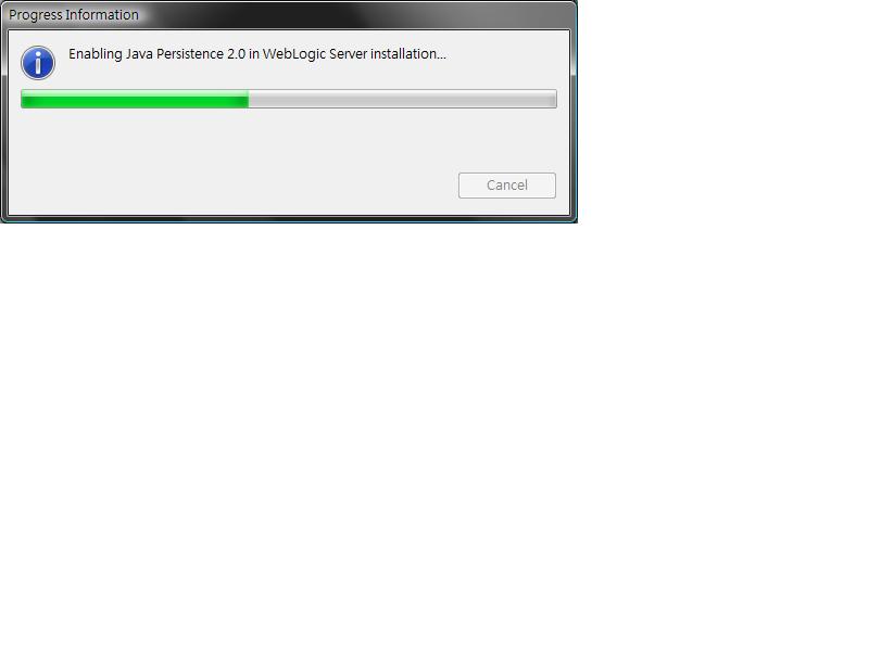

Re: cannot use eclipselink 2.x [message #898221 is a reply to message #898055] Wed, 25 July 2012 23:03 Go to previous messageGo to next message
I think success this time according to jpa15.jpg.
I need delete the WLS in eclipse first, then restart eclipse, add WLS in eclipse, and while adding, click the Install link for Java Persistence 2.0.
I check in window explorer, weblogic.jar and oepe-contributions.jar is updated.
