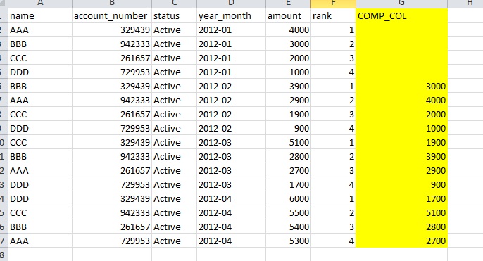

Hi everyone.
I have a dataset like on the attached picture. I would like to add computed column (yellow one) which will show value for the same account but for previous month. Is it possible at all?
Thanks in advance for any help!
Arthur

Re: Data Set Computed Column problem [message #896572 is a reply to message #896509] Wed, 18 July 2012 19:59 Go to previous message
Yes this is possible. If you are using 3.7.2 or greater you may want to
look at the crosstab report item with a relative time period aggregation.
http://www.eclipse.org/birt/phoenix/project/notable4.2.php#jump_9
If you using a table you could add a group that is not shown and then
add an aggregation element that aggregates by group. You would not
display this aggregate but you could add to its expression to store it
in prevmonth js var which you would display in the table. If you need
help with this approach post the data in the xls file and I will mock up
a quick example for you.
Jason
On 7/18/2012 11:22 AM, Arthur K wrote:
> Hi everyone.
> Arthur
