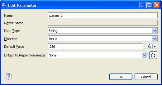

Im using the latest version of the BIRT All in one 4.2. The below query for the data set works fine with the value for SITE_CODE as '230'.
select SITE_CODE, TRANSACTION_ID, SERIAL_NUMBER from status_header
where STATUS = '120'
and COMPLETE_DATE = '20120716'
and SITE_CODE = '230'
However when the query is modified as below to receive the SITE_CODE as Input by adding he Dataset Input parameter of String type with the same Default Value as 230, the Preview Results of the data set is not showing any results
and SITE_CODE = '?'
I'm not linking the parameter to any Report Parameter as the basic feature of default value is not working.
Please let me know the issue. Im not able to use Dynamic queries linking the Data Set parameters with Report Parameters as Default value for Data set parameter itself is not working.

I changed '?' to ? removing the quotes in the query but now it gives sql error (Cannot get parameter type, Unsupported feature) :
org.eclipse.birt.report.data.adapter.api.AdapterException: An exception occurred during processing. Please see the following message for details:
Failed to prepare the query execution for the data set: Outbound Site Data Set
Cannot get the type for parameter: 1.
org.eclipse.birt.report.data.oda.jdbc.JDBCException: Cannot get parameter type.
SQL error #1:Unsupported feature ;
java.sql.SQLException: Unsupported feature at org.eclipse.birt.report.data.adapter.impl.DataRequestSessionImpl.execute(DataRequestSessionImpl.java:644)
Please find the detailed error message attached.
Are String types for dynamic parameters not supported by BIRT?

I tried with both Oracle 10g & Oracle 11g and nothing worked.
And the issue is not specific to datatype as it is not working with Integer type either.
Looks like the latest version of BIRT is not supporting dynamic parameters this way for Oracle datasources as per the below topic:
http://www.eclipse.org/forums/index.php/mv/msg/367290/894990/
Shall I switch to previous version - 3.7.2?

You can use a script work around, but I would give a day or two to see
if the bug:
https://bugs.eclipse.org/bugs/show_bug.cgi?id=384925
gets updated.
Jason

I tried with BIRT 3.7.2 and it works fine now.
