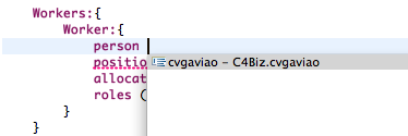

To exemplify I've attached an image of content assist that uses the scope created by the code below. index.php/fa/10715/0/
Repair that the content assist shows me a name with its parent at side and it inserts rightly the name without the parent after selection. Before, content assist was showing only the name, different from any other proposals in the editor that uses the default.
