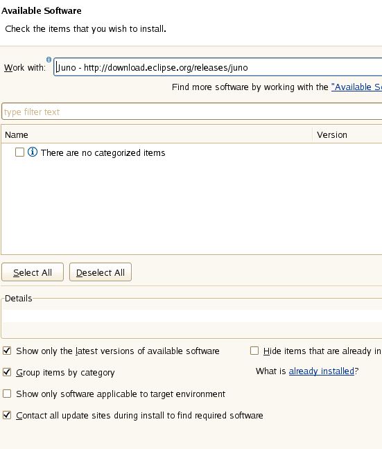

Everything starts fine; however when I go to "Help" > "Install New Software" and then select the update site "Juno - http://download.eclipse.org/releases/juno". However I get a "There are no categorized items" message. When I uncheck the "Group items by category" check box then I get what appears to be list of the top-level IDE packages, e.g. "Eclipse for Testers", "Eclipse IDE for C/C++ Developers", etc... I was able to install from the "Market". My 32-bit install is working fine.

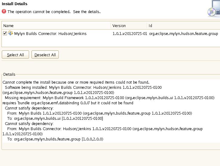

The user has full access to this folder. The Program runs completely fine but when I try to install plugins using the dialogue "Install new software..." I got issues with unmet dependencies, which could not be installed for many different plugins I tried to install (e.g. Mylyn connectors, Actifsource, Atlassian Jira, Subversive) and all of those plugins - required by the listed ones - seem to be coming from the softwaresite "Juno - http://download.eclipse.org/releases/juno".
Following screenshot shows the initial issue when e.g. trying to install Mylyn Hudson Connector, but the Issue is not(!) just with this plugin but with countless others, too (notice Version 0.0.0 of the missing dependency):
index.php/fa/11069/0/
So as a second try I opened the Juno-software-site and it found no packages on the site:
index.php/fa/11070/0/

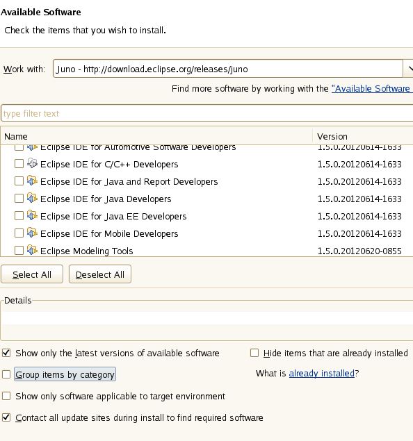

As can be seen nothing is found. Unchecking the box "Group items by category" leads to some "metapackages" (dont know how to call them) to be shown:
index.php/fa/11071/0/

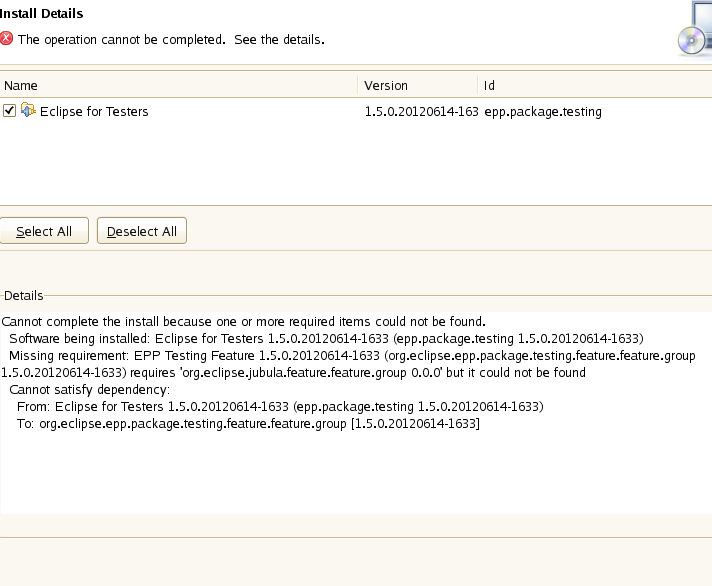

Those I cannot install as well, see next screenshot (notice version 0.0.0 for the missing dependency):
index.php/fa/11073/0/

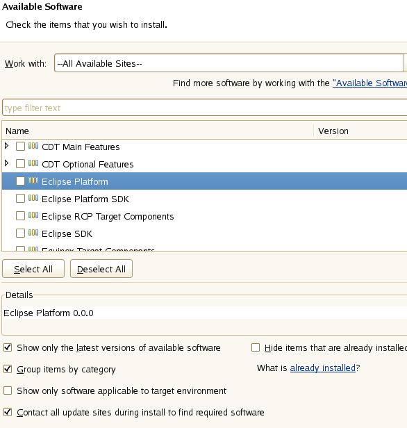

When I select "All available sites" in the "Install new Software"-Dialogue I get the categories of the Juno-software-site but they are empty and clicking one of them it shows up version 0.0.0:
index.php/fa/11072/0/
