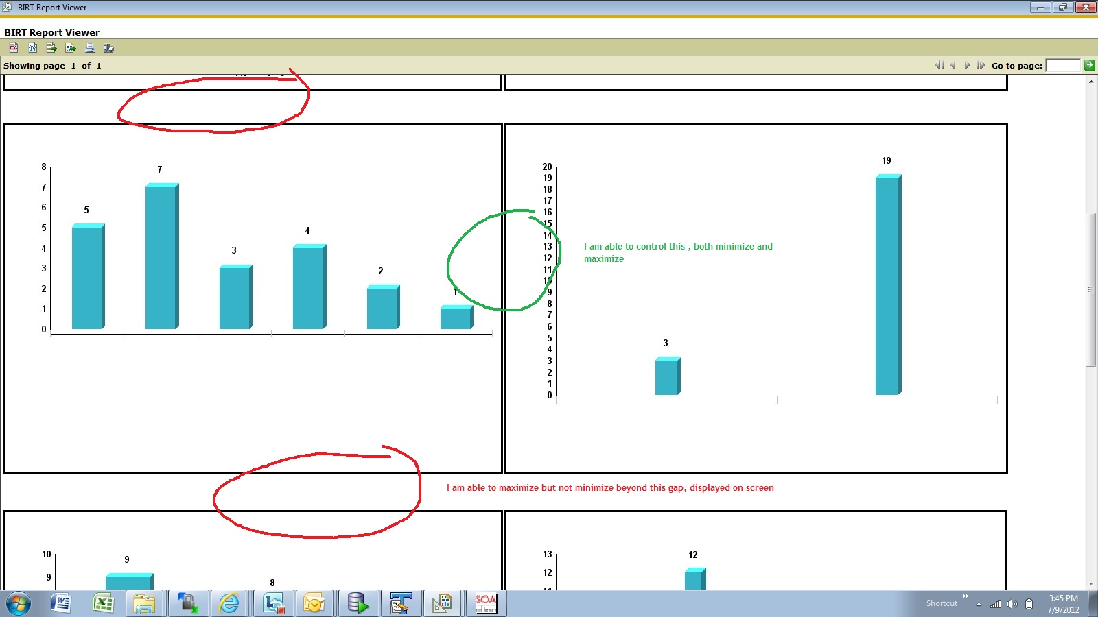

Hi I am using grid to arrange multiple reports . While displyaing the gap between rows , I am not able to minimize.
Attached the screencapture, highlighted the issue part in red circle.
Please help with your inputs.

Are the grids in a table? Can you describe your layout, or attach your report?
Re: Grid Display [message #894852 is a reply to message #894654] Tue, 10 July 2012 14:57 Go to previous messageGo to next message
No, grid is not in table. I have grid with 2 coulmns and 4 rows. In each cell I have embedded a report, which contains a table and chart. My table is hidden and chart is visible.

Re: Grid Display [message #894856 is a reply to message #894852] Tue, 10 July 2012 15:28 Go to previous messageGo to next message
I am able to see the required display by using two separate grids for tables and charts.
I wanted to know does this create any issue ? Because, here input to my chart is table. I am using a script to populate the values from table to chart in required manner.
Friends please respond with ur suggestion.

Hi Jason - Sorry for the delay in response .
I tried to reproduce the issue, in different ways. I am able to find the same issue when I tried with the different screen resolutions . My underswtanding is , display is changing depending on the the screen resolution. Correct me if I am wrong.
