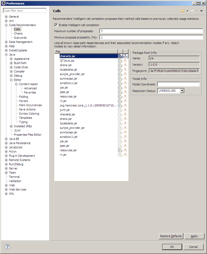

Hey guys,
I'm having the very same issue in my environment - I can't get it to work. I can see the following information under /.metadata/.plugins/org.eclipse.recommenders.completion.rcp.calls/call-models-0.5.json
"C:\\jdk6\\jre\\lib\\rt.jar": {
"location": "C:\\jdk6\\jre\\lib\\rt.jar",
"status": "UNRESOLVED",
"error": "No call model found for \u0027C:\\jdk6\\jre\\lib\\rt.jar\u0027. Neither fingerprint \u0027625a0fd26235ee06f0b6f5bb3d8dcf801c3c84ec\u0027 nor symbolic name \u0027rt\u0027 are known."
However, the file rt.jar is present in this folder.
Re: Code Recommenders do not work for me [message #893989 is a reply to message #893988] Fri, 06 July 2012 06:51 Go to previous messageGo to next message
But your .metadata/.plugins/o.e.recommenders.rcp/ flder contains the
index files?

I'm from Brazil and the internet connection I'm currently using is pretty good actually. I tried your suggestion anyway and I didn't notice any change in this direction. All the other features from this plugin are working properly, except for intelligent call completions.
In Window -> Preference I noticed that all jars are being presented with a question mark symbol, and their resolution status are all 'unresolved'. Is this the expected behavior? Is this somehow related to this issue?
index.php/fa/10602/0/
Thanks!!!

Re: Code Recommenders do not work for me [message #894013 is a reply to message #894004] Fri, 06 July 2012 07:48 Go to previous messageGo to next message
This is expected as downloading the models fails with a timeout. The
icons change as soon as the models are on the local disc and ready for use.
