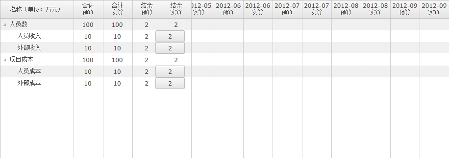

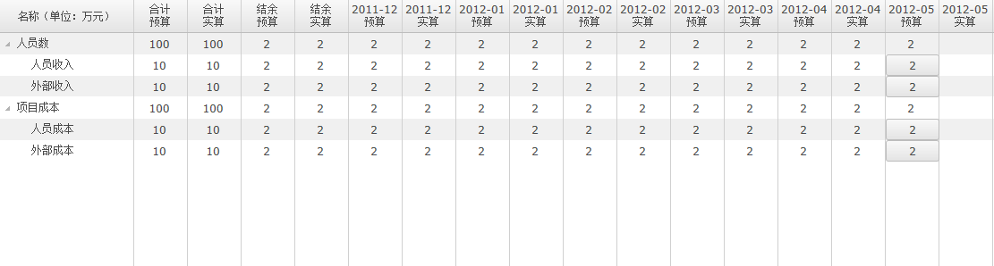

Re: about RWT.FIXED_COLUMNS [message #893916 is a reply to message #893669] Thu, 05 July 2012 23:03 Go to previous messageGo to next message
Snippet 1
Tree treeVirtual = new Tree(compActual, SWT.BORDER | SWT.FULL_SELECTION);
treeVirtual.setLayoutData(new GridData(SWT.FILL, SWT.FILL, true,
true, 1, 1));
treeVirtual.setLinesVisible(true);
treeVirtual.setHeaderVisible(true);
treeVirtual.setData(RWT.FIXED_COLUMNS, 5);
Snippet 2
private TreeItem createItem(TreeItem parentItem, String str, String str1,
String str2, String str3, String str4, String str5,
String str6,String str7, String str8) {
TreeItem citem = new TreeItem(parentItem, SWT.NONE);
citem.setText(str);
citem.setText(1, str1);
citem.setText(2, str2);
citem.setText(3, str3);
citem.setText(4, str4);
citem.setText(5, str5);
final TreeEditor editor = new TreeEditor(treeVirtual);
final Button button = new Button(treeVirtual, SWT.NONE);
button.setText("test");
editor.grabHorizontal = true;
editor.setEditor(button, citem, 6);
citem.setText(7, str7);
citem.setText(8, str8);
return citem;
drag the scroll bar button does not hide?

Re: about RWT.FIXED_COLUMNS [message #893924 is a reply to message #893916] Fri, 06 July 2012 01:55 Go to previous messageGo to next message
you mean that the cell editor (button) is not hidden behind the fixed
columns when scrolling right? If this is the problem - this is done by
design. Try to hide the editors (buttons) yourself by listening for the
horizontal scrollbar selection event. If you think that this is not
correct please file an enhancement request.
